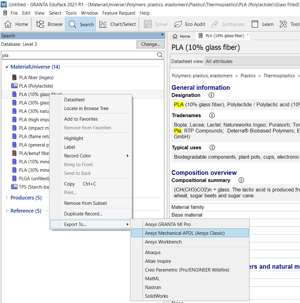

David Mercier
Ansys Employee -
April 22, 2021 at 9:56 am
Haad Ali Gujjar
SubscriberI have never used this earlier. Is this a separate software or the built-in for ANSYS ?
April 22, 2021 at 1:16 pm
David Mercier
Ansys EmployeeIt's an Ansys stand alone software, but Granta EduPack is only for academics, here for more details: https://www.ansys.com/products/materials/granta-edupack
Otherwise look into Granta Selector or Granta MI: https://www.ansys.com/products/materials/granta-selector / https://www.ansys.com/products/materials/granta-mi
Selector and EduPack can be directly opened from Workbench for example if you have both installed and licensed. Both are also integrated in Workbench workflows (engineering data...).

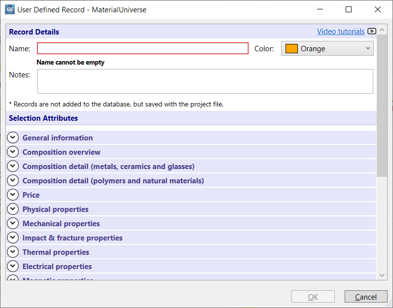

September 24, 2021 at 9:11 pm
Ezzad
Subscriber.Hi dmercier,
I couldn’t find the EduPack in Workbench. Where can I find it? I wanted to use PLA material as well.
September 26, 2021 at 6:45 am
David Mercier
Ansys Employee.Hi, it is not in the Workbench installation package. It is a separate software to download on the Ansys Customer Portal. Here for more details: /forum/discussion/32112/does-edupack-or-selector-work-with-workbench-or-discovery/p1?new=1
