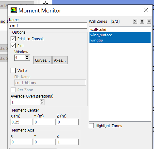

Ansys EmployeePlease insert the picture instead of attaching it.nApril 15, 2021 at 2:49 pmApril 15, 2021 at 3:09 pmDrAmine
Ansys EmployeeAnd so now the question: What do you want to achieve? You want to monitor the moment coefficient along two walls at a certain center and along a certain axis.nFluent Theory Guides describes the math behind that. nApril 15, 2021 at 4:07 pmNidhiramy
Subscriberi want to find the pitching moment coeffcient for wing. i just want to know if the points are r8 for the above conditionsnApril 15, 2021 at 5:04 pmDrAmine
Ansys EmployeeIf not elsewhere referenced for low speeds the aerodynamic center is at 0.25 of the chord length.You need to provide correct stream values in the reference values area or just get the moment around the center and then scale outside of Fluent nViewing 5 reply threads- The topic ‘pitching moment calculation’ is closed to new replies.
