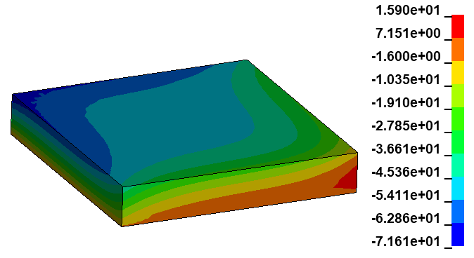

      I tried to perform a simple piezoelectric using LS-DYNA: a piezoelectric block with a fixed bottom surface and a pressure load on the top surface.
      I have referred to the results from some other examples, the voltage results are evenly distributed.
      As done in LS-DYNA, the results do not have such a distribution but are skewed as shown in Figure 2.

      To get a uniform voltage response across the body, I suggest you delete the Fixed Support and replace it with three displacements: X=0 on one face with an X-axis normal, Y=0 on one face with a Y-axis normal and Z=0 on one face with a Z-axis normal. In each displacement boundary condition, the other two displacements are left Free. This will allow the body to freely expand on the free sides due to Poisson's Ratio effect as the pressure compresses through the thickness.

        Thank you for your suggesstion. I tried it but the results are the same.
        Voltage result:
        When I active the piezo effect, all results look not good (it is always skewed in a certain position)

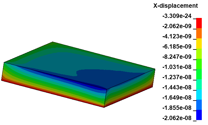

        Here is X-displacement (direction of force)
      The results are not the same, but I see it is not what you want.
      The voltage in your original post goes from   -66 to +25 volts.
      The voltage with the new boundaries is from -71 to +16 volts.
      Maybe someone else will have a suggestion.

      In the ABAQUS image – bottom is grounded – do the same in your model (ground -> volt=0).
      Finally I think in the ABAQUS model has pressure both on top and bottom
      In general it is hard to use the PZT as the anisotropic mat. properties are hard to set up.
