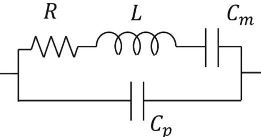

      I took a long time to connect the equivalent circuit of the piezo material (Quartz) to its electrodes (attached on both sides of the quartz), gave it sine voltage, and did a harmonic analysis to see the amplitude of piezo oscillation in the specific range of frequency. I added the CAD data directly to the workbench and added the APDL commands (attached) to the modal analysis (added before the harmonic analysis). Based on the errors I receive " Element 18590 does not have all of its required nodes defined.  The E command is aborted" I am guessing that the problem is with nodes and elements that I introduced. It would be really appreciated if you can help me with this issue.
      I attached the equivalent circuit and the APDL codes, Thanks in advance for your help.

      Yes, the nodes 1,2,3,4 allready exists in the workbench mesh/model so can not be used again (find the last node number and add 1 and use that in the new nodes).
      You can see in VM237 how to use circu94 with solid226 piezo – in there you will see that he pzt starts from node10 (
      NUMSTR,NODE,10),
      then it is ok to define N,1 and so on since these nodes do not exist.
      Also look for posts in the forum (e.g., : /forum/forums/topic/ansys-2021-workbench-piezoelectric-analysis-add-resistor/)

      As an alternative to Erik's suggestion, you can interrogate the MAPDL database for the highest numbered node that exists in the model. Let's call it NMAX. This command:
      *get,NMAX,node,,num,max
      will define parameter NMAX and set its value to the highest numbered node in the model. You can then create additional nodes to construct the CIRCU94 elements:
      n,NMAX+1,xlocation,ylocation,zlocation
      n,NMAX+2,xlocation,ylocation,zlocation
      By the way, APDL is not case sensitive.
