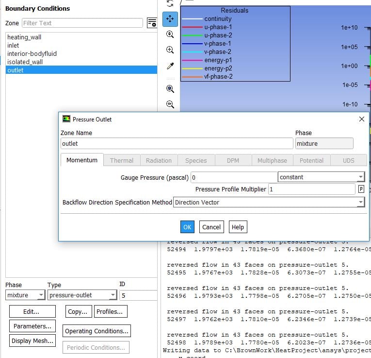

      outlet:
      pressure-outlet
      Gauge Pressure (pascal) : 0
      Backflow Direction Specification Method: Direction Vector ( ???? actually I think there is no backflow in that example )
      phase-1 (water-liquid) - temperature 590 K
      phase-2 (water-vapor) - temperature 590 K

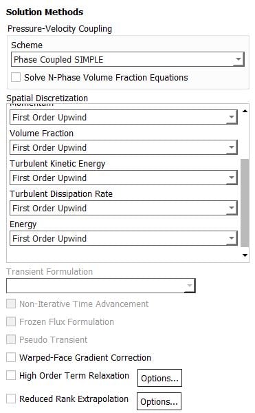

      Please post a screenshot of the deployed solution methods.

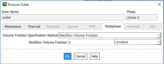

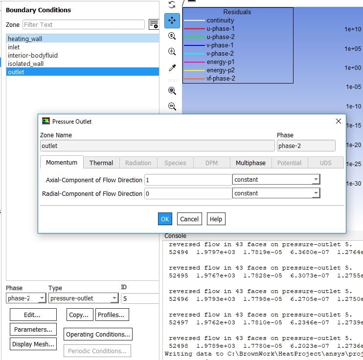

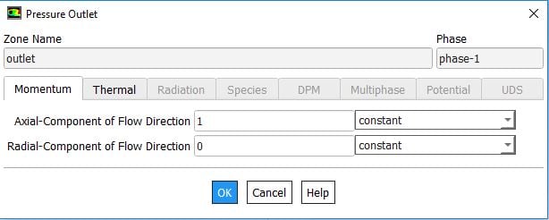

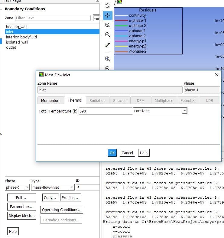

    • mossaied2
      Here is the solution method screenshot

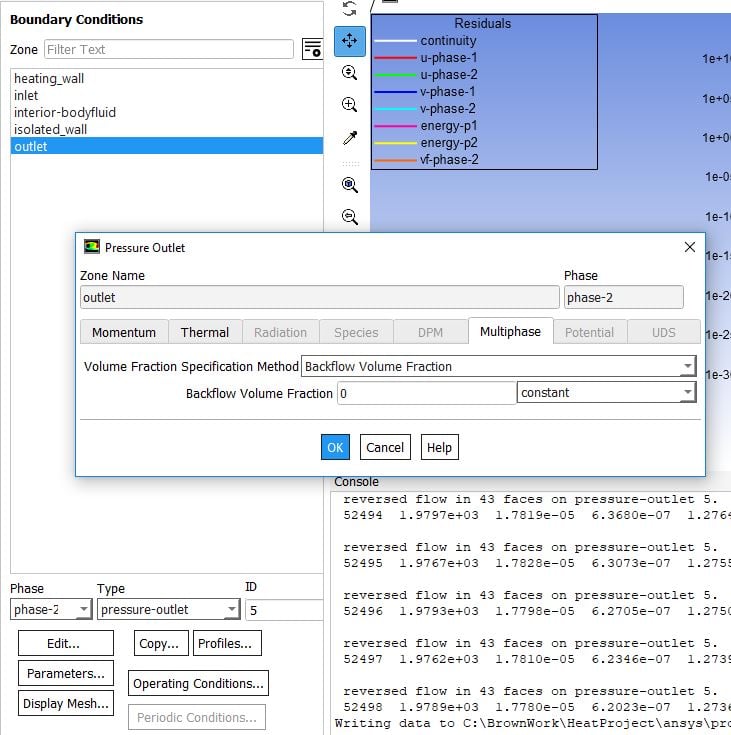

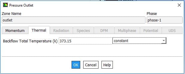

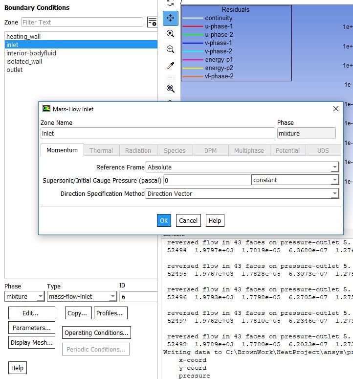

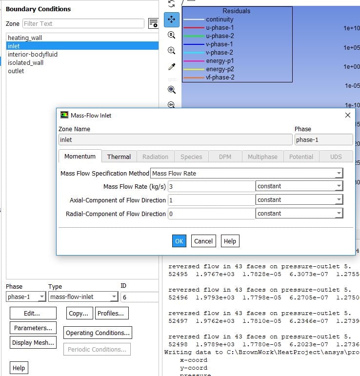

      Here is my operating conditions. The flow is parallel to the axis of the cylinder (x-axis) so the gravity in -x directions. It is 2D axisymmetric model.
      inlet BCs (mixture (scr-shot1) ,
       phase-1 (scr-shot2,3),
      and phase-2 (scr-shot4,5))
      outlet BCs (mixture (scr-shot1) ,
      phase-1 scr-shot2,3
      and phase-2 (scr-shot4,5,6)) - as you see in scr-shot6 I suppress the backflow although I am getting backflow in my simulations
      The backflow message
      The kind of convergence curves I am getting after more than 50000 iterations
      I am really sorry for this lots of pictures reply, and thanks in advance for your understanding

      1/Species an Operating density. Choose zero here for example as you have only one outlet and the pressure at outlet is known
      2/Use Body Force Weighted or PRESTO! for pressure interpolation
      3/Use Coupled Solver with Pseudo-Transient option
      4/@10.8 MPa is the saturation temperature 589.95 K. Please check you inflow B.C for water as you are coming already here with 590 K.

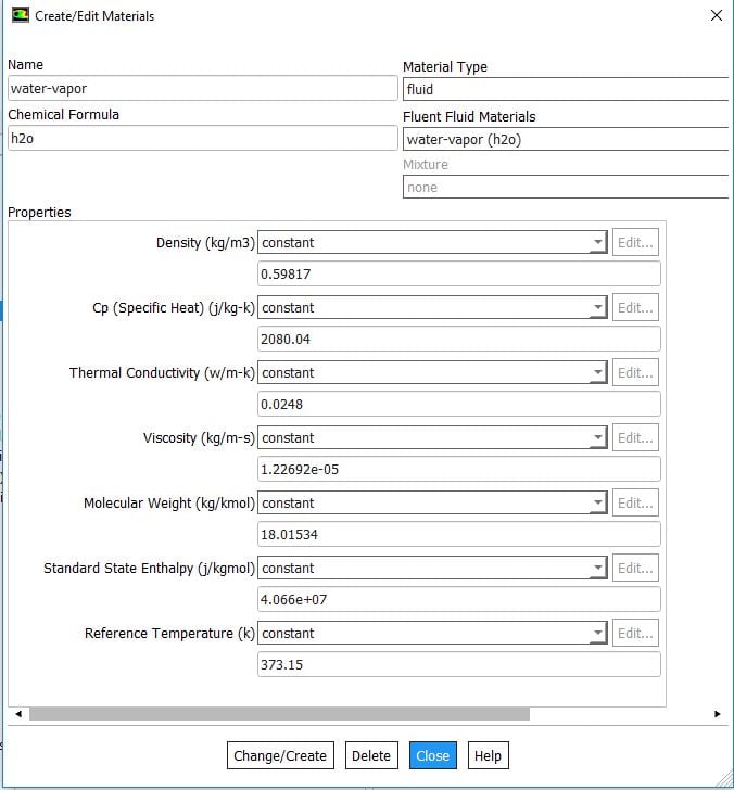

      I am now setting densities as constants with no Boussinseq
      also I set latent heat of enthalpy of water to 0 as you advised and set it to 2.28e+07 j/kg.mol (with no negative sign)
      but still I have divergence in the continuity residual, after 1000 iteration it was around 5.4688e+03 and the curve show slow increase!
      Also I have doubts regarding the saturation pressure corresponding to 590 K saturation temperature. How can I tell Ansys that the saturation pressure is 108 bar?. Or if I can't set the saturation pressure to 108 bar, can I know what exact saturation pressure that ansys will consider when solving the problem, so that I can set the operating pressure to the same value?
      Thanks in advance
    • DrAmine
      Set the operating pressure 108 bar and setup all other material properties to the ones @Saturation temperature @108 bar and use that temperature as the reference temperature for the materials.. ANSYS Fluent will look into the saturaton temperature you are defining /using under Mass Transfer model.
    • mossaied2
      That is a great idea Mr Amine,
      I have a small question, now the properties of water and vapor at the saturation temp should be the same?
      I came to that conclusion since that website http://www.spiraxsarco.com/Resources/Pages/Steam-Tables/wet-steam.aspx that calculates the properties of water at different saturation temp/pressure needs the percentage of dryness of the vapor. I noticed that if I entered the minimum percentage ~0 of dryness (means the evaporation just started and the steam is very wet) the properties are almost identical to saturated water. In that case, I found myself putting almost the same properties for both water-liquid and water-vapor except for the standard state of enthalpy.
      Plz correct me if I am wrong?
    • DrAmine
      They should not be the same as you are above the critical point . You have to provide different input for density viscosity heat capacity and heat conductivity

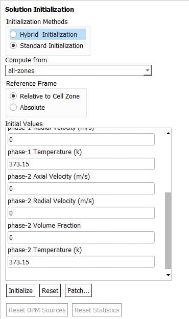

      20- Solution initializations (compute from all zones)

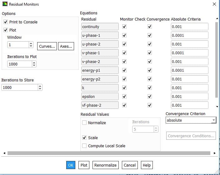

      21- residual monitors
      22- solution controls (all set to 0.01)
      23- convergence curves (all below e-3 except continuity ~42)
    • DrAmine

    • mossaied2
      I think my calculation of Enthalpy is wrong!
      I multiplied latent heat 2256400 J/kg by Molecular weight 18.01534 kg/k.mol the results should be 4.066e7 J/k.mol ???? not J/kg.mol ???? as ansys requires, can somebody plz correct me and show me how I get the latent heat in J/kg.mol?
      The way I did what I did is based on 2 ansys forums but seems I have a big misunderstanding
      I searched google many times to find some tables that define enthalpy in J/kg.mol but no luck so far, so I am sorry if my question is a naive one this due to the different background
      Thanks

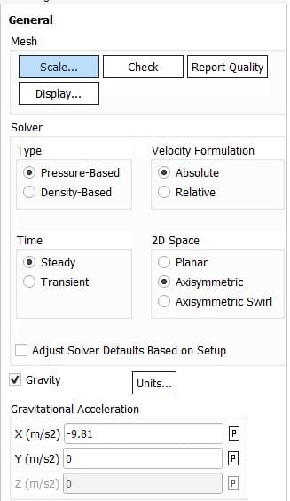

      Also I could not understand "My monitors for integral if mass transfer is equal to vapour mass at outlet"

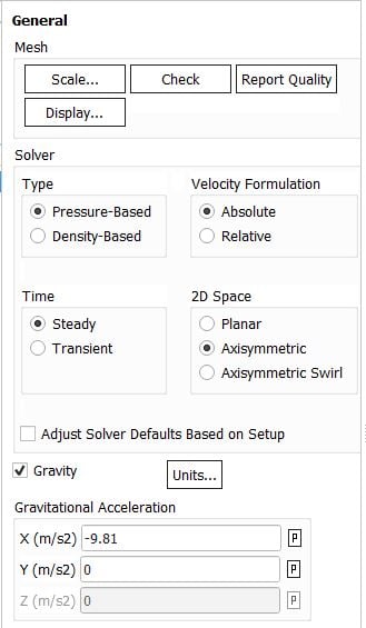

      I think I am setting 2D Axisymmetric, plz check the following image if I am setting correctly
