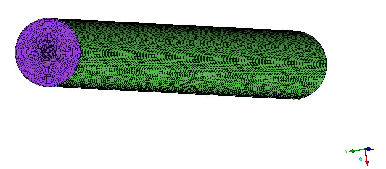

I created on ANSYS-ICEM a cylinder closed on both side as the picture below :
As far as i know my mesh is fine, my criteria were :
- Angle > 18 °
- Quality > 0.3
- Aspect Ratio <1000
- Determinant >0.3
- Volume change <10
- Erikson skewness >0.8
Tell me if something is wrong with these criteria.

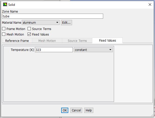

I fixed the temperature value of the cylinder to 323 K :

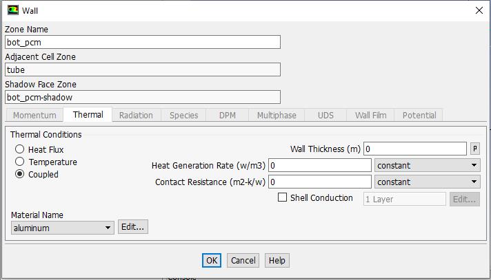

For boundaries between PCM and the cylinder, "coupled" was chosen : (The picture only show the bottom boundary)

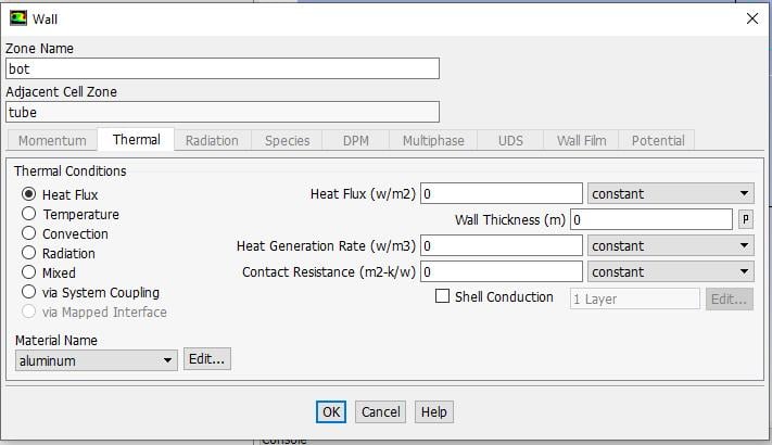

For boundaries between the cylinder and the exterior, i just made them adiabatic :

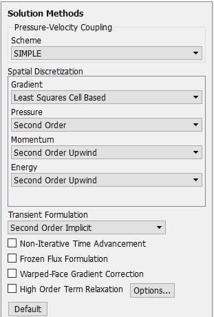

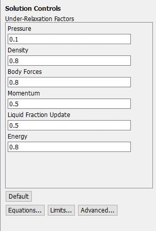

The following pictures shows the methods and controls used :

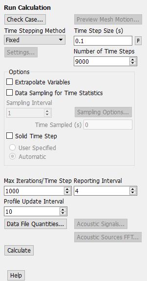

The following picture shows my parameters for the calculation :
The residuals are set to 1e-6, i choose 1000 for "Max iterations/Time set" to ensure that the beginning of the calculation converge.

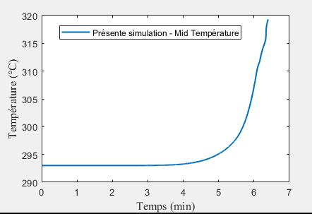

This is a plot of the temperature of a point in the middle of the cylinder. But we can't see a plateau where the phase change appears.
Where is/are my errors ?

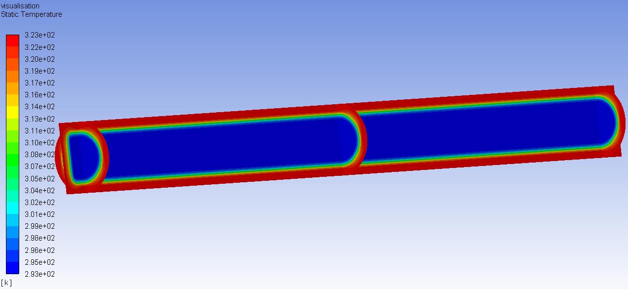

Forum ModeratorPost a few images of temperature on a plane.Â
