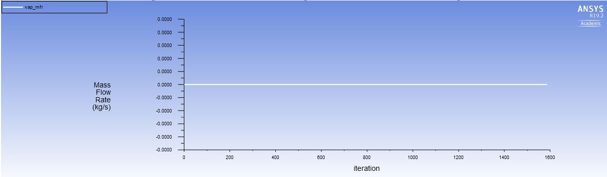

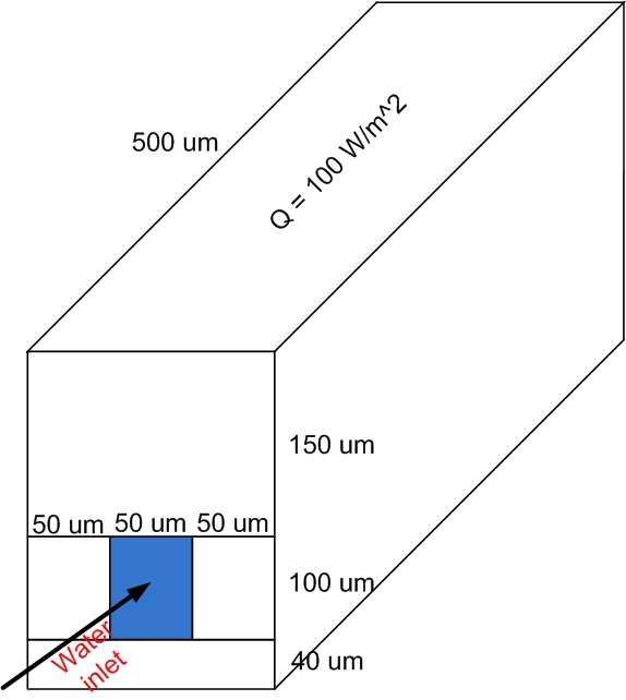

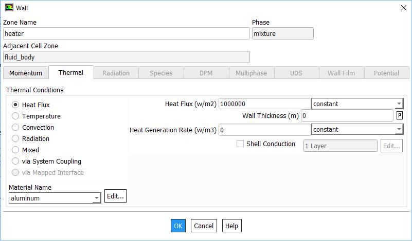

My model is a micorchannel of cross-section 50umX100um in XY plane, and extended in Z direction for 500um. This channel has inlet at XY plane with water flowing inside at 323.15K at a flow rate of 1e-5 Kg/s. The upper wall of this channel has a heat source of 190e6 W and the water is saturated and I set the operating pressure equal to the saturation pressure of the (12352 Pa from NIST webbook). The 190e6 was calculated such that I have 2e-6 Kg/s of vapor at the outlet whereÂ
outlet_mass_flow_rate_vapor = input heat x upper surface area / latent_heat
although I did not get any vapor at the outlet? so what would be the reason for that?Â

Ansys EmployeeSo you are getting zero vapor at outlet. Can you post-process the mass transfer variable and post screenshot here?
November 29, 2018 at 2:18 pm
November 29, 2018 at 2:37 pm
DrAmine
Ansys EmployeeI asked for Mass transfer rate under phase interactions.
November 29, 2018 at 3:26 pm
November 29, 2018 at 3:55 pm
DrAmine
Ansys EmployeeNo I asked for the contour plot or volume integrals of the phase interaction to check if it is always zero overall

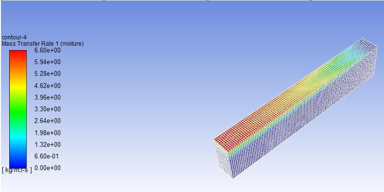

Ansys EmployeeThere is a mass tranafer rate variable please do a contour plot for it at a certain plane in the middle and draw mesh on it as my colleague has already pointed
November 29, 2018 at 6:36 pm
mossaied2
SubscriberThanks a lot for the support. I am trying to report that mass transfer rate variable but I do not know from where in fluent I can set it.
in post-processing module there is a variable called "phase mass source"? is that the one required?
Thanks
November 29, 2018 at 7:00 pm
DrAmine
Ansys EmployeeUnder phase interaction.
And ensure that the mass transfer is from liquid to vapor.

I have made some changes and now my model can be highlighted as follows:
Eulerian - evaporation-condensation - saturation temperature 323.15
laminar flow
I changed the material properties to be at operating temperature of 323.15 for both vapor and liquid water. I set the Enthalpy of water as 0 and vapor with the difference between the 2 enthalpies at 323.15 K (after conversion to j/kgmol by multiplying the difference by 18.0152 - the molecular weight of water). I get the material properties from NIST workbook
still rectangular micro-channel with cross section of 50um width, 100um hight and 500 depth. The upper wall is heated with heat = 1e6 W/m^2 (100 W/cm^2)
velocity inlet with liquid entering with speed 0.708 m/s - 323.15 K, and vapor entering with zero velocity and 323.15 K. This 0.708 m/s is equivalent to 700 kg/m.s mass fluxÂ
pressure outlet with zero gauge pressure and outlet temperature 323.15 K to avoid super heated vaporÂ
operating conditions - pressure 12352 Pa = saturation pressure, no gravity
methods -> Pressure-velocity coupling - scheme (coupled) -Â Pressure (Presto) - others set to their defaults -Â Pseudo transient
initialization - Hybrid - and I patched vapor to fluid body with 0 volume fractionÂ
calculations - time step method (User specified) - pseudo time step (0.001)

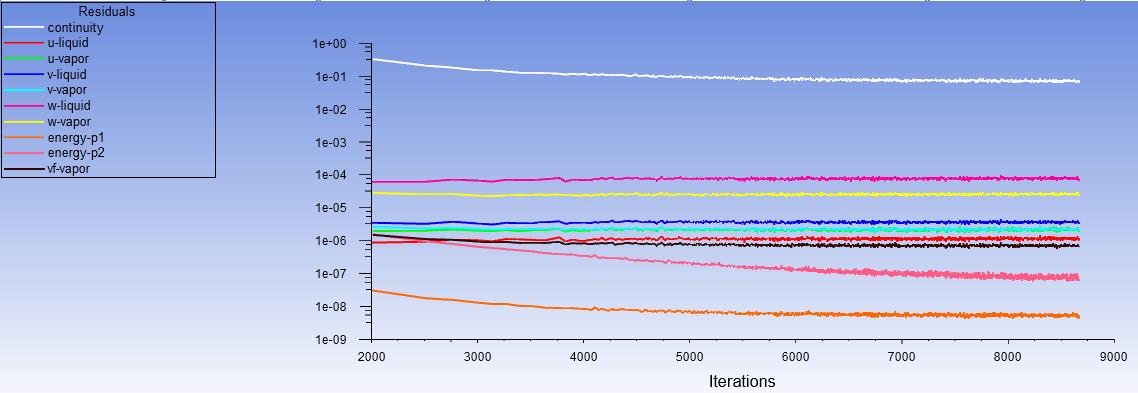

All the convergence curves are below 10^-2, although I have made another check that did not show good result at all

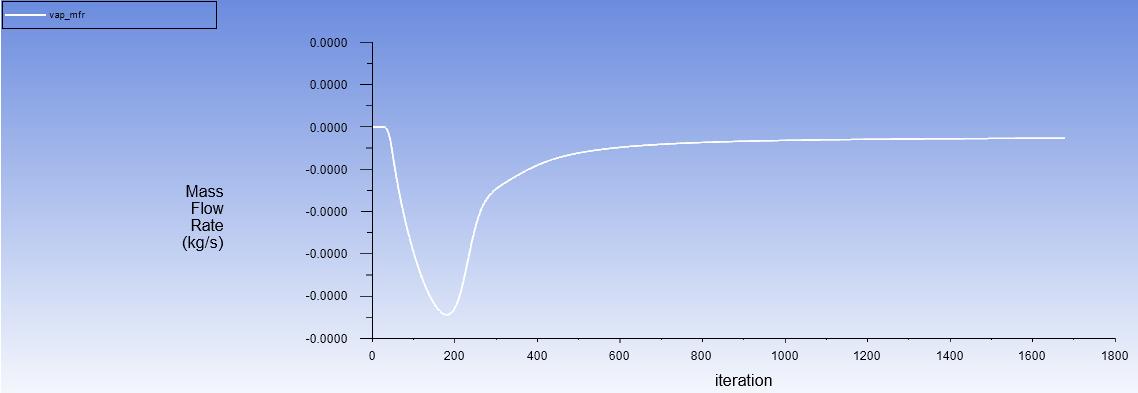

for 10^6 W/m2 I entered on the upper wall of the channel I should be getting 1.049 e-8 kg/s vapor at the outlet according to the following equation:
mass flow rate of vapor * latent heat =Â Â 10^6 * area of the upper wall
what I got from the simulation was :
vapor
Mass Flow Rate (kg/s)
inlet -0
outlet -1.2587459e-12
Net -1.2587459e-12
of course 1.2587459e-12 is very far from the theortical value 1.049 e-8Â

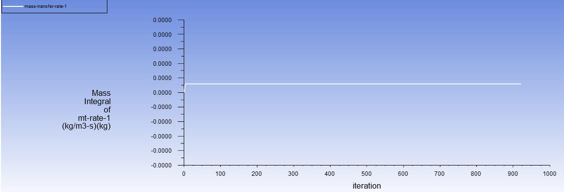

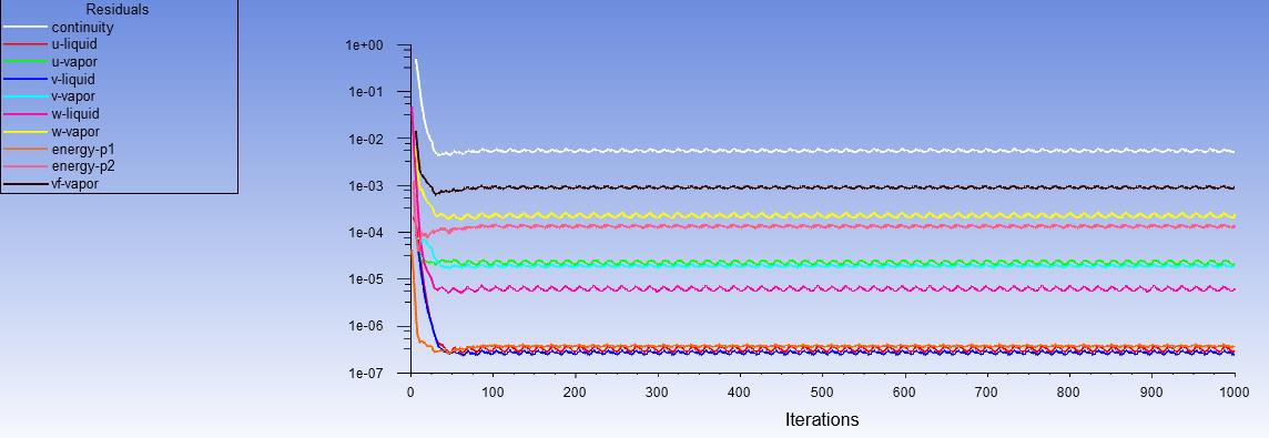

Here are the convergence curves

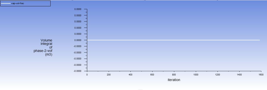

Here is the mass integral (mass transfer rate) inside the fluid-body zone
mass transfer rate vs iterations
 Any help would be appreciated!Â

I reran the simulation and recorded the mass-transfer-rate and I found that continuity does not converge a lot, it stabilizes at ~0.3 also the I have a big error between the expected vapor mass flow rate and theoretical one. I was expecting 1.049e-8 kg/s while I got 1.e-9 kg/s only at the outletÂ

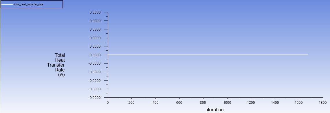

I was recording the total heat transfer rate in the fluid-body and it seems there is a problem in that regard because I think it is almost zero as shown in the following picture. That is really strange since I am setting the heat correctly to 1e6 W/m2
Here is also the mass transfer rate. It looks strange since it is only high near the inlet! I was expecting that as the sat water flows more in the channel, more vapor is generated.Â
and vapor volume fraction at the outlet

Ansys EmployeeRun for more iterations at first and then report.
What about the heat transfer between the phases?
December 6, 2018 at 4:33 pm
mossaied2
SubscriberOk Mr Amine I'll do that, I just wonder how to report heat transfer between phases, what I am reporting right now in the simulation, is from Report Definitions -> Flux -> Heat Transfer Rate then I choose once liquid and once vapor, is that right?

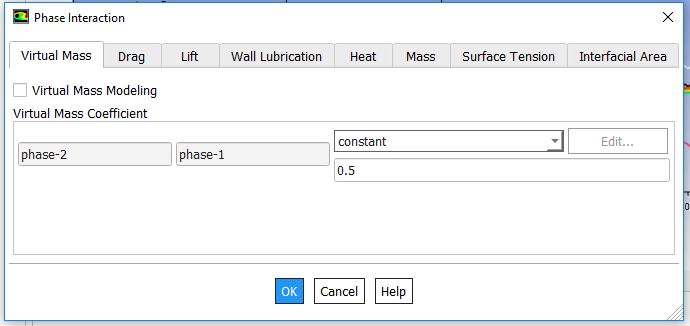

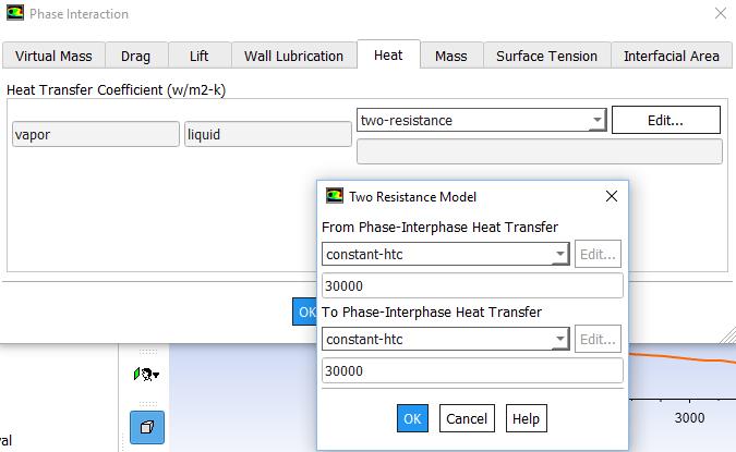

Ansys EmployeeNo thats ist not right and is not easy to do. Once again please add a screenshot of the heat tranfser interaction panel.Â
December 6, 2018 at 5:00 pm
mossaied2
SubscriberOK Mr Amine, so how to report "heat transfer between the phases" I googled that with no useful results.
Also where is this "heat tranfser interaction panel"Â so I can report?
Thanks Â
December 6, 2018 at 7:06 pm
DrAmine
Ansys EmployeeIs not stored in Fluent. You will need to reconstruct it.
Phase Interaction Panel> Heat transfer. -

SubscriberHi Mr Amine
Actually when I choose evaporation-condensation, ansys automatically switches to two-resistance model with no options to change. I also left the default setting of the two-resistance model which is From phase ranbze-marshall and to phase "zero resistance"Â
I really doubt this the to-phase setting "zero resistance" as I think vapor has more resistance than water?Â

mossaied2

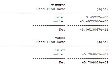

SubscriberI set both From/to Phase-Interaction Heat Transfer to constant instead of ranbze-marshall and zero resistance as default setting. The constant as shown is 30000 W/m^2.k, where I got this value from some paper. what I am really worried about is the dimensions that ansys waiting in these two settings. so is W/m^2.k is right. ?
I got the best convergence I could ever get since I start this work, with all residuals below 10^-4 except continuity it was bouncing between 6.8e-02 and 7.2e-02 (still very much better than my previous trials).
The error between mass flow rate from fluent and the theoretical value get reduced although it is still big difference, now while I should be getting ~1.049e-8 kg/s at outlet I am getting 5.7e-9. The error yes still big 45% but before it was 1000 times less than the expected value.Â
I think the problem really was in the Heat Transfer Mechanism between phases. I think also the correct setting of HTC would lead to more convergence.

Ansys Employee The volume integral of mass transfer rate has to be equal to the mass of the vapor from outlet. If this is true then it is fine. Your case is not realistic and consequenlty convergence by residual will not be amazing. What is your application?
The whole run is sensible for interfscial, area and htc. A part of the heat to the wall will be used to heat up the vapor which is formed. you will not get the ideal mass of vapor as it does not remain saturated. For this eutopic case it is better to assume water as saturated and as such to use zero resitance for it.Â

My application a lot similar, a rectangular micro-channel for silicon cooling as shown bellow.
I was only simulating the fluid part because in that case I am sure all the 100 W/cm2 heat applied will be consumed in sat water and hence I can estimate the vapor flow rate at the outlet and compare that value to the one coming from my simulation. After becoming sure that this simplified model is working by getting the expected vapor rate at the outlet by changing the heat input, then I can go safely to the complete model shown above.
