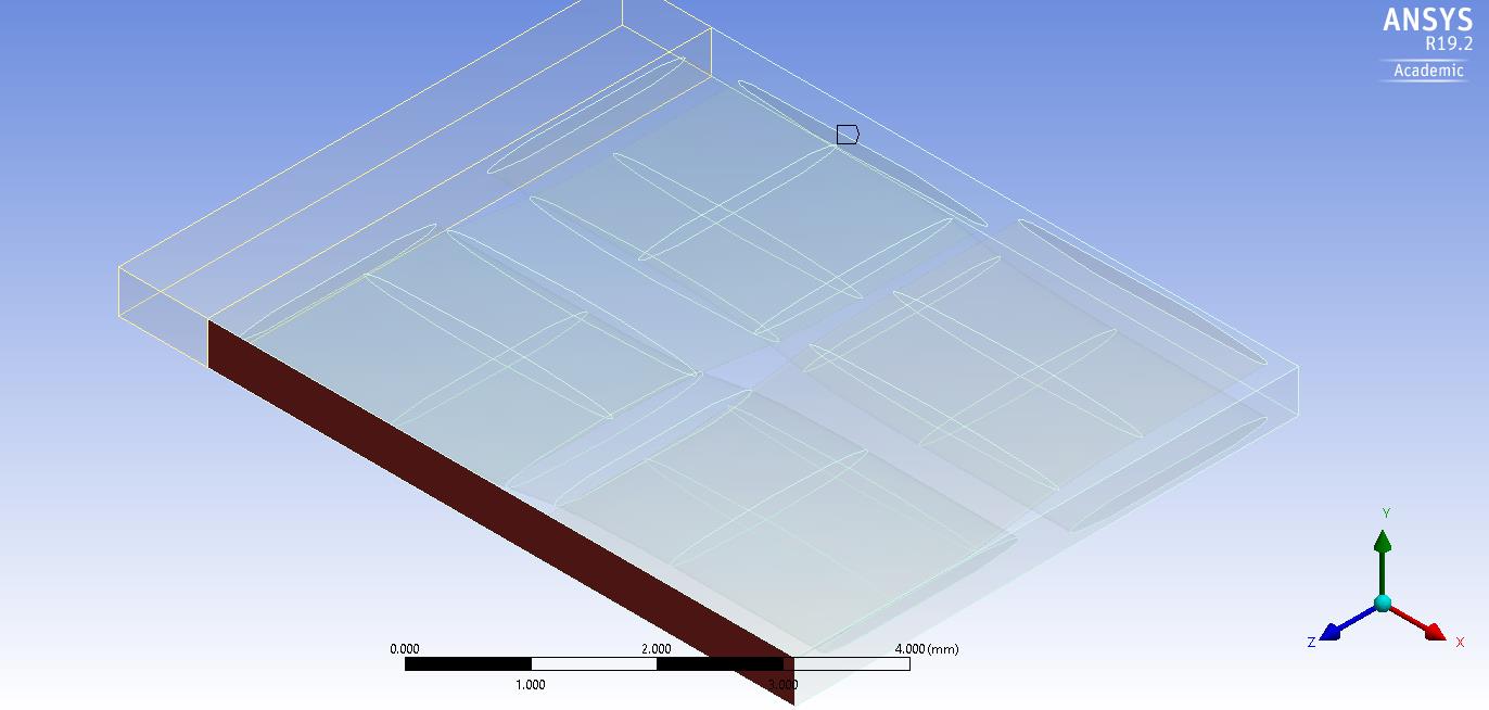

I'm encountering issues when trying to make periodic boundary conditions for my 3d design.
when making 2d design, i easly assign periodic by this approach and that works well; however, in 3D it says periodic fails
>mesh/modify-zones/make-periodic etc.
can you guys please help in this, and where am I wrong for 3D case.
February 10, 2020 at 6:00 pm
DrAmine
Ansys EmployeeIf that conformal periodic fails just use non conformal periodic interfaces.
