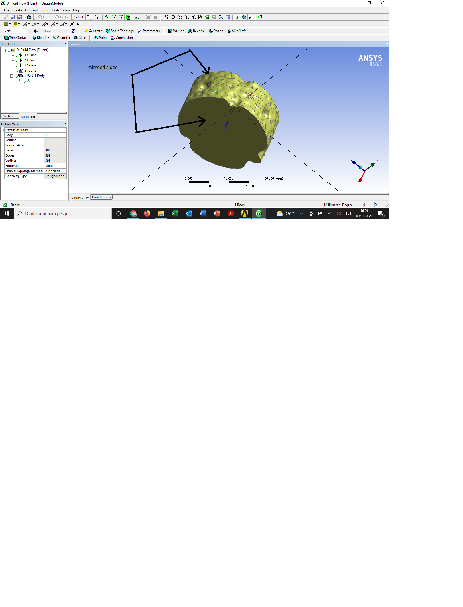

I am setting up a simulation of a complex tube geometry, dimpled tube. Since the actual length would require computar capabilities not available, I decided to run periodic analysis. However, everytime when I try to create the periodic zones, the following message appears:
warning: number of elements does not match between zone 6 and 7.
error: failed to make zones periodic.
error object: #f
I am sure that both opposite sides of the tube (inlet and outlet) are identical. I say this because they are mirroed sides. Yet, I still get this message. I have changed multiple parameters but still get the same error.
I have also read many post here, on cfd.com and researchgate. I have even tried face matching control. No success.
Any clue on what should I do or extra material that I could read and get a possible solution for this?
I have attached an image of my geometry.
Thanks in advance

Forum ModeratorHow did you mirror the mesh? Periodic boundaries need an exact node/facet alignment so if you didn't force this it often fails. However, if you ensure you have two separate labels and turn them to interface you can create a nonconformal periodic via the Mesh Interface panel.

I used the mirror tool from DM. First I got half of the tub with the repeating geometry, and then I used the xy plane to mirror.
Is this non-conformal technique the window enabled when I select the inlet, for example, as interface within boundary conditions ? Or should it be done in the meshing ?
November 10, 2021 at 4:59 pmRob
Forum ModeratorYou've mirrored the geometry, that doesn't mean the mesh is the same. The non-conformals use the surfaces you pick (define) as "interface" in Fluent, you then create the "interface pair". It's simple when you know how. Unfortunately in the current release the "assistant" isn't working quite right, so it needs turning off, https://ansyshelp.ansys.com/account/Secured?returnurl=/Views/Secured/corp/v212/en/flu_ug/flu_ug_sec_nonconform_using.html
Then use Mesh Interfaces from the tree (left side menu) to create the pair. Read any prompts carefully.

Forum ModeratorI'm not permitted to open attachments (check Rules for why), but you do need an offset for translational periodics. Otherwise the solver doesn't know how long the modelled section is (Fluent knows the cell sizes etc but the solver can't see a distance between two surfaces).

SubscriberIt is working now.
The problem was that I thought I only needed the periodic boundaries condition. But after create the mesh interface, the zones created must be treated as conventional (not periodic) boundaries. I changed the inlet and outlet interface zones to inlet mass flowr ate and outlet pressure, respectively, and set the values.
Problem solved.
Thanks a lot Rob.
November 12, 2021 at 4:16 pmRob
Forum ModeratorIt'll work, but that's not a periodic model.
