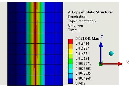

      Hi everyone,
      Can anyone help me out with the penetration problem as shown in the image.
      Thank you
      Hi Junaid,
      Maybe the contact definition needs a much larger Pinball Radius. That is a parameter in the Contact definition that you can change.
      If you create a Workbench Project Archive .wbpz file and attach it to your post, it will be easy to show you what changes are needed to your model.
      Peter

    • Sandeep Medikonda
      Junaid,
      Try the following:
      • Change the Normal stiffness from program controlled and use a factor of 5 or 10 even. If needed, change update stiffness to Each iteration.
      • Change the formulation from Augmented-Lagrange to Normal-Lagrange. This will eliminate nearly any penetration, but make sure that you are using the direct solver in the analysis settings.
      • Lastly, as Peter suggested, use a higher pinball radius by changing it from program controlled to manual and make sure that the contact regions are being properly closed by the blue transparent guide ball that shows up.
      ~Sandeep

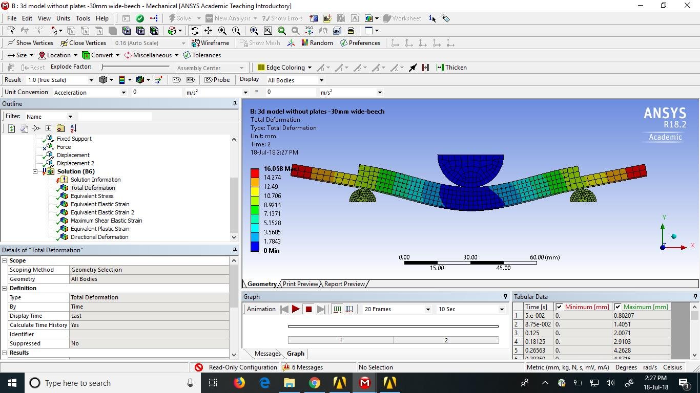

      Junaid,
      I will repeat what I was adding to my note above in case you missed it, since your reply was already there when I was done editing: It is very important to turn Large Deflection On.
      As I look more closely at your model, I see a Metal Strap that has two Steel "end blocks" and between them is a Beech wood block. You have used Bonded contact between the Beech wood block and the Metal Strap and the "end blocks" but it seems to me that the Beech wood block is placed into this steel assembly with no bonding between the faces.  I expect the Metal Strap is in fact bonded to the "end blocks". Is that correct?  If so, then there should be frictional contact between all the Beech wood parts and the steel parts.  Am I right?
      Peter
      Junaid,
      Thank you for the photograph, that confirms my assumption. There should only be frictional contact between the steel and the wood. That is what I have done in the attached model.
      A better way to connect the steel end blocks to the steel strap is to put those three bodies into the same part in DesignModeler. That way there is no bonded contact required between those three bodies, they will be meshed and share common nodes at the coincident faces.
      In the attached model, I created a multibody part for the steel parts. I also sliced the geometry into a half model and used a z = 0 constraint on the cut face.
      I added planes and made slices to get a higher density of nodes over the contacts on the bottom supports.
      The attached ANSYS 18.2 archive has run for a displacement of 6 mm and will run overnight to see how far toward the 46 mm final value it can get.
      Peter

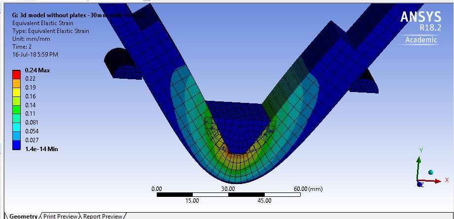

    • Adisa
      Peter or anybody,  whether in this case can  use  the mesh nonlinear adaptivity  for the mesh control? And how much the results are accurate using the mesh nonlinear.
      I added another slice to make it a quarter model instead of a half model. This makes the solution run faster, but the biggest benefit is it adds an X=0 constraint to the model, which was lacking in the half model. The half model only had X = 0 constraint once friction was established, making convergence difficult. Now getting started is much easier. Now the challenge will be getting to large values of displacement.
      Below it is apparent that the thick steel plate shown in the photograph above that is not included in the model serves a necessary purpose.
      Adisa, a large amount of plasticity can be accomodated without needing to turn on Mesh nonlinear adaptivity.
      The attached ANSYS 18.2 archive had all steel parts, and no plasticity. See the next post for rev1.
    • junaid.A
      Mr Peter,
      Thank you for the attached file.
      I am running the previous model now with the half model.
      Thank you
      Regards
      Junaid Dand
      Junaid, the half model has problems. Look at the quarter model attached here, which has the wood property with plasticity assigned to the block.  The image above is for a steel block without plasticity.  When slicing material in DesignModeler, previously assigned materials get replaced with Structural Steel, because it is assigned as a Default material. That leads to mistakes such as the one above, where I ran with the wrong material. There is a way to remove the Default material so that when slicing is done, the model gets a ? that demands correction, rather than a silent replacement of one material for another.  It is however a good practice to get a model to converge without plasticity before adding plasticity.
      Here is how far that same model got with plasticity turned on before convergence failed after 205 iterations.
       *** WARNING ***                         CP =     774.670   TIME= 06:50:22
       Plasticity algorithm did not converge for element number 800 with
       material number 7.
      Peter

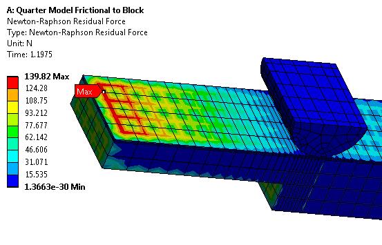

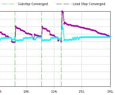

      Junaid, that didn't get any further, but it stopped because it could not converge, not due to a Plasticity.  I used the NEQIT,50 command, and it looks like if I had given it a higher number, it would have converged, but it stopped at the 50 iterations mark. Bump that number up to 100.
      Do you know how to Restart a solution from the last converged substep?
      I looked at the Newton-Raphson Residual Force, and the max value is in the tail. That may require smaller elements to converge.
      Peter

      Junaid, try reducing the element size along the tail as shown in the image above, and changing the command snippet from 50 to 100.
      Peter

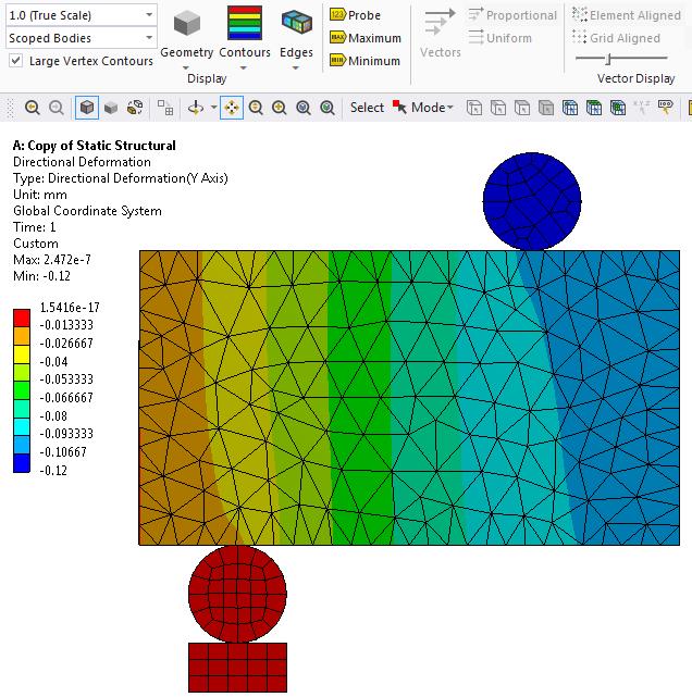

      Now I have made the change in the displacement direction as was during the lab test. I have applied displacement on the supports.
      Regards
      Junaid Dand
      Junaid,
      Are you saying that instead of moving the top center piece downward, you are moving the bottom side supports upward?  That makes no difference to the simulation.
      Why are you not taking advantage of symmetry?  The solver will run for twice as long (or four times as long if you don't run a quarter model).

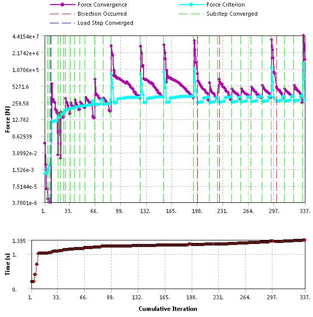

      Update on the post above. The solver hangs at increment 337 as shown in the force-convergence plot above. The first time it ran, I clicked Interrupt Solution to look at the results, but it never stopped.  I restarted that computer and reran that model and the solver appears to still be running, but it got to that same increment and goes no further.  There is no error in the solver output file, and all the ANSYS.exe processes are still showing in the Task Manager, but I believe the solver has hung.  This is a very rare outcome. Let me know if that happens for you also.
      Peter
    • junaid.A
      Mr Peter,
      Yeah, I mean bottom side supports moving upward. In order to avoid any deformation of the elements which caused errors when the symmetry condition was used earlier, I am using full sample along the longitudinal section. Below is the image of the model when it was simulated for 10mm displacement only for checking purpose.
       The same thing happened to me. But there seems no penetration when scaled 5x auto.

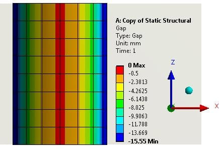

    • zoiralli
       Hello everyone,
      I am facing the same problem. Even after trying the contact options suggested in this post, I still get penetration in the concrete prism by the cylinders. Could you please help me? Please find attached my project workbench archive. Thank you in advance.
      Zoi
      Zoiralli, you are NOT facing the same problem.
      You just didn't set the display to True Scale.
    • zoiralli
      I thought that the penetration is small and that is why it is shown on the true scale. Since I don't have penetration, could you please explain what is the negative gap that I am getting from contact tool in results?
      You don't have massive penetration, you have a very small amount of penetration, which is normal.
      Impactor shown in the image below.
      The gap is zero at the center of the impactor where there is penetration, as shown in the red zone.
      There is a gap away from the center up the sides of the cylindrical impactor.
      The gap is reported as a negative value.
