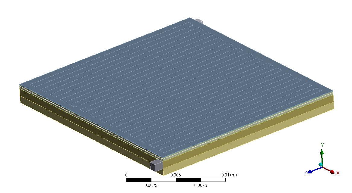

      I'm currently modelling a Polymer electrolyte membrane fuel cell and I'm facing some problems with the mesh in workbench meshing. I want a highly structured hexahedral mesh. The PEMFC consists of an MEA which is essentially 5 very thin rectangular prisims stacked on top of each other, and bi-polar plates and gas channels on the top and bottom. These channels imprint onto the surface of the MEA when I share the topology for the entire domain (which is recommended by the handbook). The middle 3 layers I can mesh using a sweep method, but the outer 2 layers cannot use the sweep method due to the gas channel imprint on the top surface (pic 1. Bi-polar plates and channels hidden).

      Don't use hex dominant method. It's designed to give a good surface & first layer mesh for Mechanical and then fill the rest in with rubbish. Either decompose the two layers so you include the flow channels or see if multizone will work. If you use the former use a named selection to put the two volumes into the same zone in Fluent.
    • HamishE
      Thanks Rob! The multi-zone method worked a treat and now the mesh is nice and uniform. I can now recombine that outer layer of the MEA into 1 layer so it's the usual 5 layers thick rather than 7.
