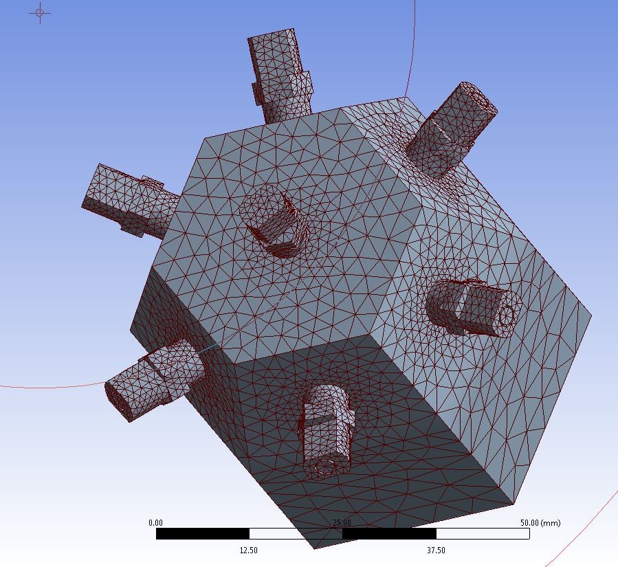

SubscriberPatch-conforming tetrahedral mesh failed because of duplicated faces in boundary mesh.

Forum ModeratorWhich meshing tool are you using?Â

I think your problem is the cell size. Have a look at the geometry and then work out what needs to be resolved: you need to make the cell size smaller than that dimension to capture the CAD. In this case the cells are big compared to the nozzles so it's linking bits of model that it shouldn't.Â
You also need to think about what you're going to model, and why. Is the petrol a separate phase, ie are you spraying petrol into air?Â

It is part of 2000mm long and 160mm diameter pipe, having nozzle head inside. Pipe already carrying petrol, nozzle head takes petrol and starts sprinkling to the other side with 6 different nozzles. Nozzle head will be placed at 800mm distance from one end. what would be the best way to approach this?

Forum ModeratorSo, are you modelling the nozzle, or the distribution of fuel in the head? Have a look at the sizing you need to resolve the features and then try meshing again.Â

Ansys EmployeeWhen you get any error, use right click and use go to object. It points out the location or face where problem is coming.Â
Then change the settings accordingly.Â

I am doing fuel distribution. I am trying to increase the number of bodies in design. I will update this as soon as I can.
