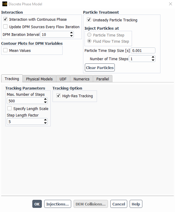

      1.) Enable DPM
      2.) Under DPM, check the "Interaction with Continuous Phase" and "Unsteady Particle Tracking" boxes

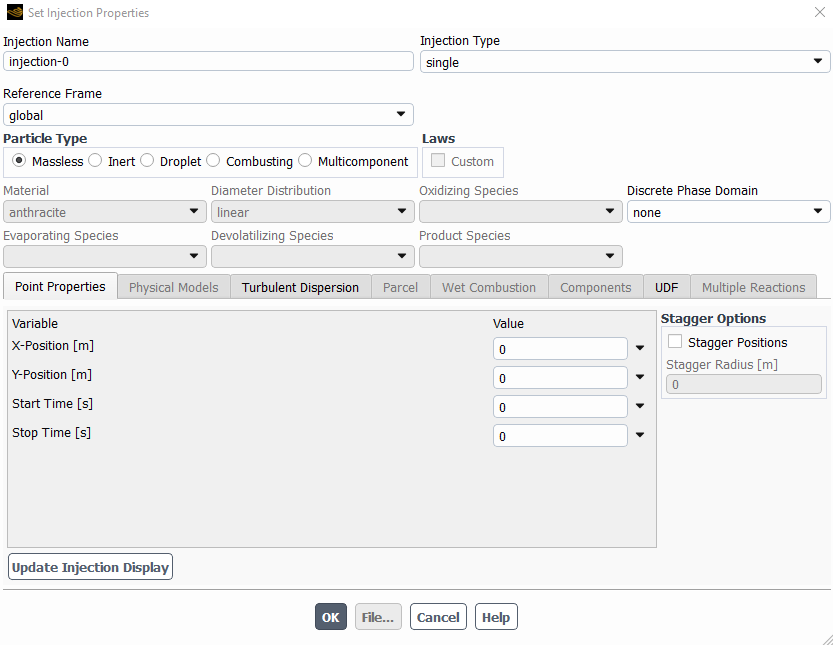

      3.) Define a new injection
      4.) In the new injection, set Particle Type to "Massless" and Injection Type to "Single"
      5.) Leave all other injection settings as default (in my case X-Position: 0, Y-Position: 0, Start-Time: 0, End Time: 0)
