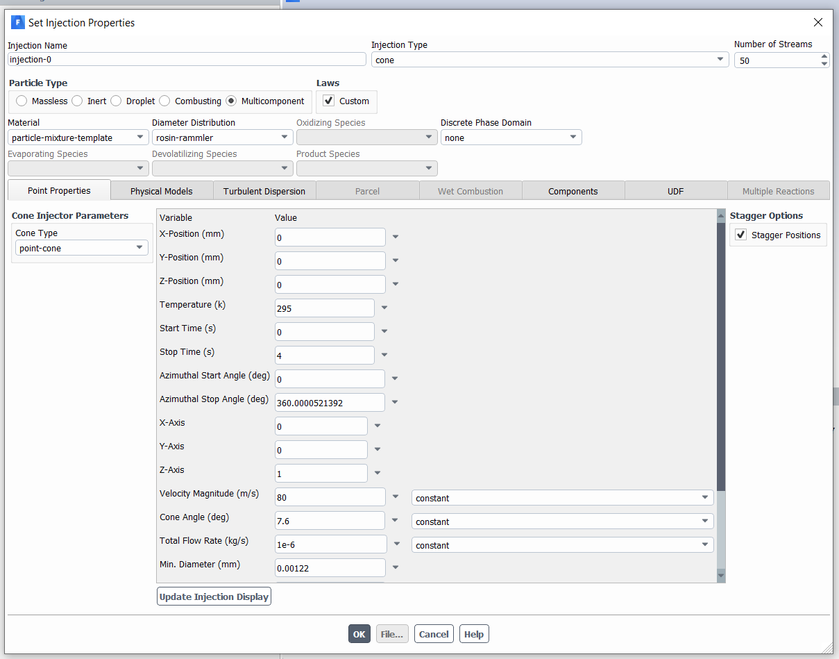

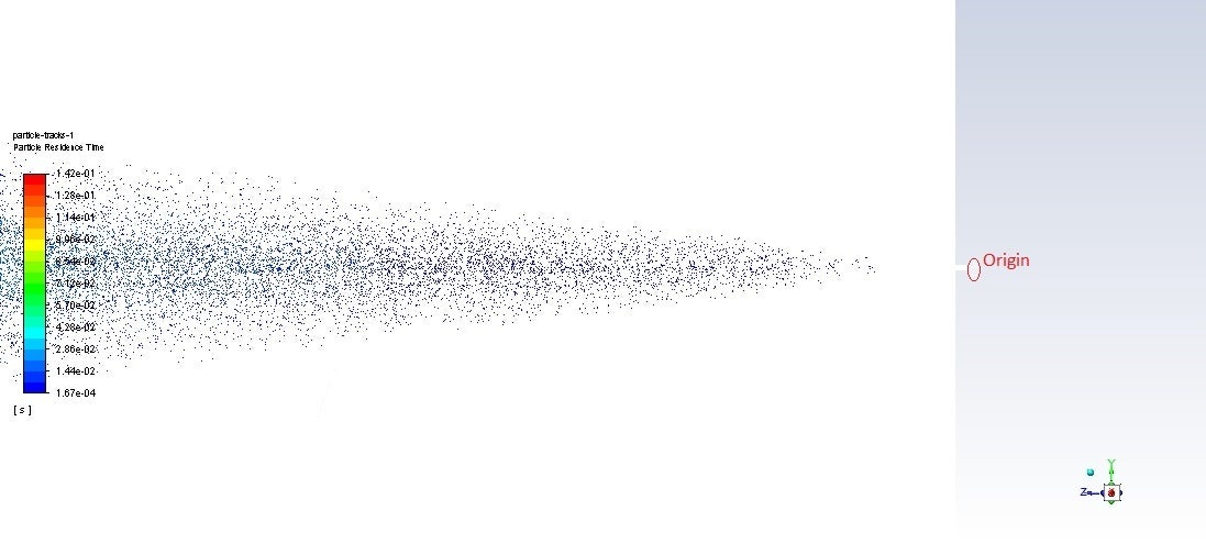

SubscriberI simulated spray by the DPM model. In the results, particle tracks are not shown from the origin of the nozzle. I mean, it shows particles from a few cm far from the nozzle exit. What should I do to have particle track from the exit?
May 10, 2022 at 11:04 amRob
Forum ModeratorHow did you set up the DPM injection?
May 10, 2022 at 3:07 pmMay 10, 2022 at 3:58 pmRob
Forum ModeratorIt looks like the cone injection is supposed to have a gap between the point and start of where the droplets are tracked https://ansyshelp.ansys.com/account/Secured?returnurl=/Views/Secured/corp/v221/en/flu_ug/flu_ug_sec_discrete_cone_props.html
