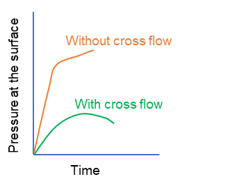

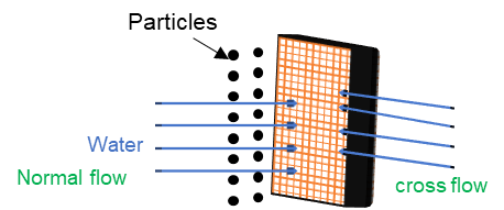

      I want to see the effect of cross-flow in self-cleansing of the filter. Can this be simulated in the fluent using dpm model?
      Sort of, read up on the porous media model (it's a cell zone condition). There are lots of things we can simulate, and in most cases it's more a question of you understanding the physics of the problem to then apply the software.
