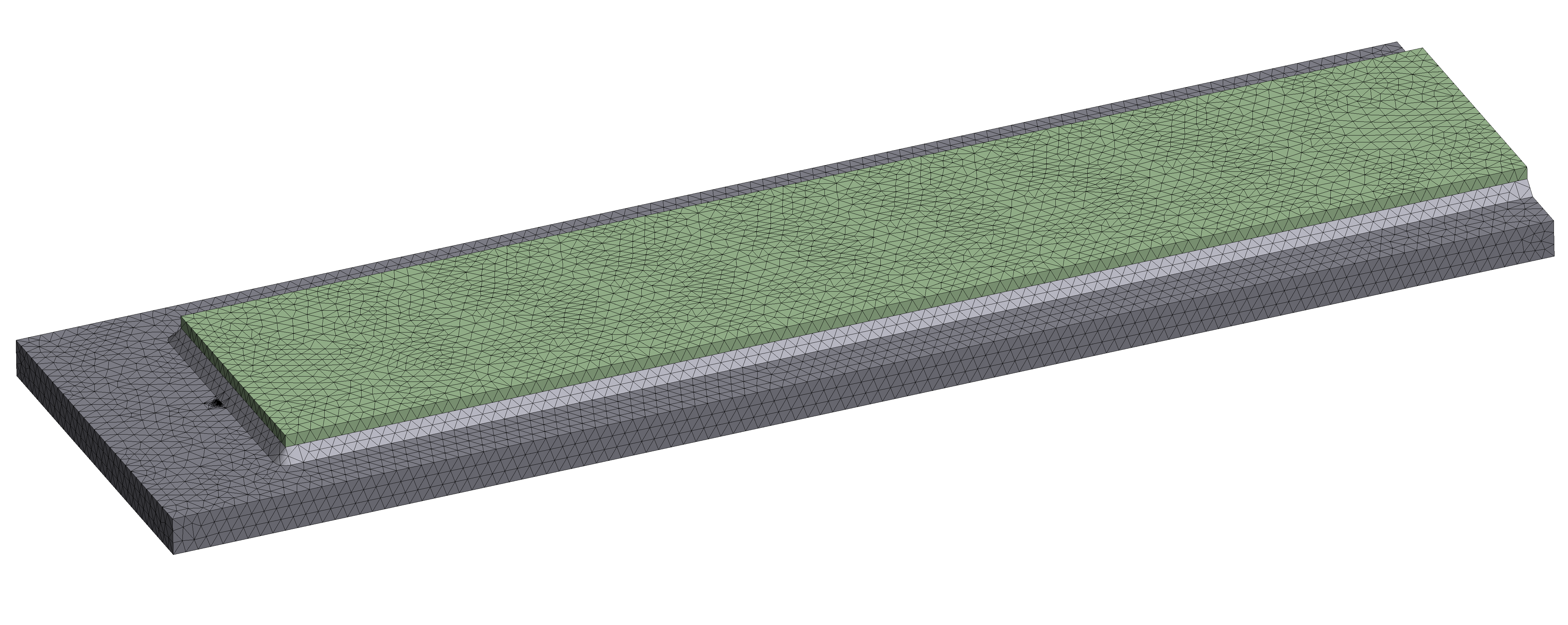

      I have the following model and a question regarding it:
      my model contains a plate and on top of this plate is a smaller plate (cover plate) welded. Also there is a crack in the beginning of the weld, as you can see:
      See picture below:
      The mode is fixed at the right end and it is pulled on the left end, so the model is under a tension.
      I modelled the geometry with DesignModeler.

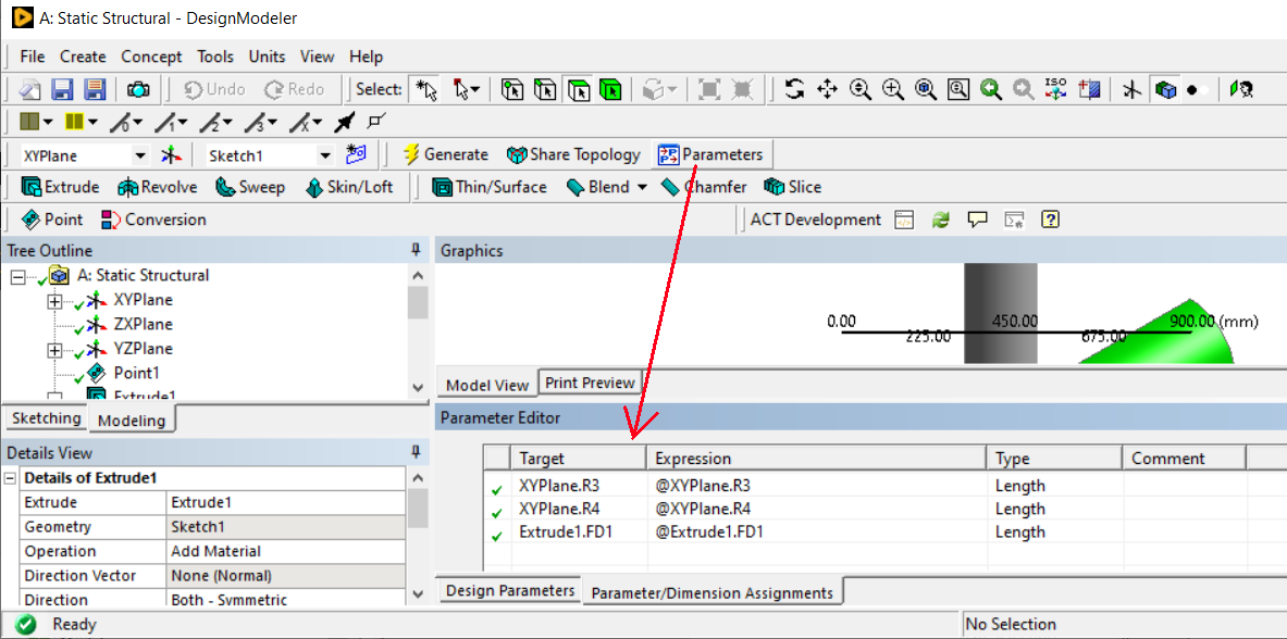

      I need to do a parameter study with this detail for the stress intesity factor K (SIFS K1). To do this I parametrized all lengths, widths, thiknesses, distances with the marked "P".
      1.: Is there a way to make the parameters dependent on each other? For example that the length of my plate is 3 times the width of the plate?

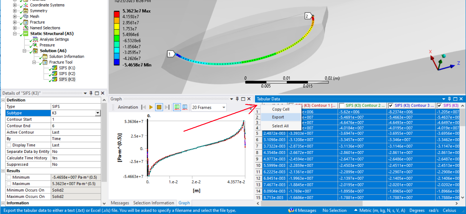

      2.: If I use the designpont option, can I get the all K1 and not just minimum and maximum, so is there a possibility to parametrize all K´s? or can I put them in a file to save them. (otherwise I have to keep all solutions and change the actual model, open the model look at it, and do this over and over)

      1. Use the "Parameters" button in DM to define relations to promoted parameters:You can also set relations between some parameters in workbench page if they are input parameters. Set the "Expression" field in the "Parameter Set":
      You can look up both of these further in the Ansys online documentation.
      2. The way that the Ansys applications are set up to do this is to click the "Retain" checkbox for design points. After running the solutions on the design points (otherwise known as "Updating" them), you can right click on a design point row to "Set as Current." Then "Edit" any of the Mesh, Setup, Solution, or Results cells to open Mechanical. In the SIF result, you can right click on the grey box to the upper left of the history data, and choose "Export":
      This will export all the SIF values for each contour at each time point for a particular K1, K2, or K3. It writes a tab delimited text file you can open in Excel or any text editor.
