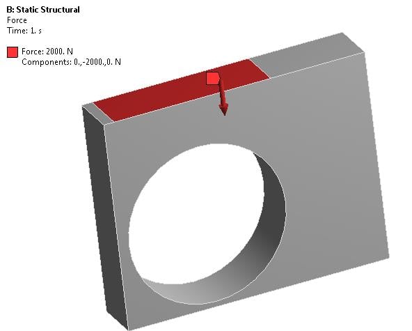

      I am trying to make a parametric optimization of a hollow plate, using as objective the mass reduction and constrain the FOS, with DesignXplorer

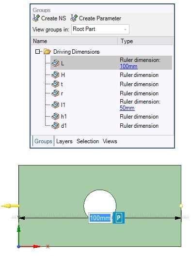

      I have used the following parameters in Spaceclaim:
      • L: length
      • H: height
      • t:thickness
      • r: hole radius
      • l1: distance between the hole's center and one vertical side
      • hi: distance between the hole's center and one horizontal side
      • d1: the force placement
      I tried to use some dependencies between the parameters. The L,H, t and d1 are updated after using the candidates DP but the radius and the position of the hole remains stable. I have tried some alternatives with no chance. Can someone help please? I attach the project in order to take a look.

      DP 0 is not a problem. The length, L, is defined from the right edge...
      ...while the location of the hole, l1, is defined from the left edge.
      If you manually update the geometry to DP 1 with l1 first, and then L second, here is what you get:

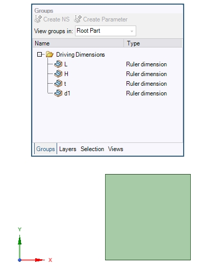

      Now look at what happens when you update l1 to 75 mm...
      It pushes the hole outside the solid.
      Now there is no hole. All the parameters that belonged to the hole are deleted.
      You can't type in 25 mm again because the parameter l1 doesn't exist!

      I tried the same with the force placement. My intention was to have a constant force area equal to 30mm with force placement (d1) that varies so i used the expression:
      d1 = 15 + fcp*(L - 30)/100
      where fcp 0-100

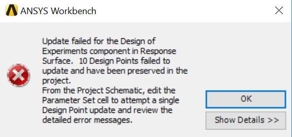

      10 DP failed. I do not know why. Is that normal? So i used custom solution for the DOE and i deleted the failed DP, is that correct?
      For the force i created a rectangular on the top of the plate and i used a dimension (d1) in the middle of it as force placement. Is that correct?
      However i could update the design at the 3 candidate DPs. But for example the predicted values in CP3 were Mass=156g and FOS=7.71 when the real are Mass=101.5g and FOS=1.43. Should we expect so big difference between the values?

      Here is what happens when the geometry goes from DP 0 to DP 10, a surface is created and Mechanical doesn't know its thickness.
      It's like when the parameter pushed the hole outside the block, things in the geometry model were broken.

      Here is where SC starts.
      Here is what SC does to the geometry when it updates from the way it was saved to DP 0
      SC is updating the parameters from top to bottom of this list. Look at the shape after updating two values.
      Updating d1 is when the surface is created.

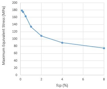

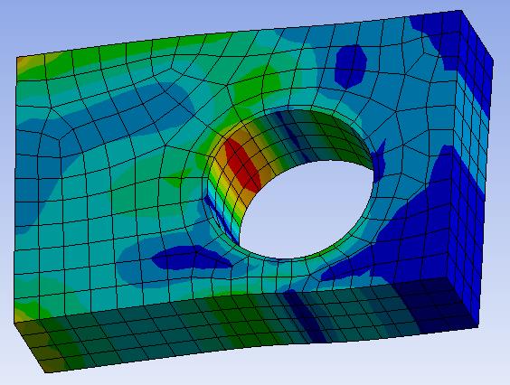

      I ran the optimization and found that the fcp parameter is introducing a significant challenge to fitting a good Response Surface to the stress data.
      The reason is you allowed a minimum value of fcp to be 0.1%.  What this means is that the 30 mm long force area gets pushed to the fixed support and leaves a tiny slice.  As the edge of the force area approaches the fixed support, the stress changes in a highly nonlinear way, and this makes it difficult to fit a Response Surface.
      If you put a more reasonable lower limit on fcp like 10% then this highly nonlinear response would not be present, you would get a better fit of the response surface to the data and the optimization prediction would fall closer to the actual simulation result.
      Here is the plot of Maximum Stress vs fcp.
      Here is the geometry for fcp = 10
      and it satisfies the stress limit of < 125 MPa.
      Now this geometry is already at the minimum mass, because L, H and t are all at the lower limit and r is at the upper limit. This tells me that there is no tradeoff needed between mass and stress to achieve the stress limit.

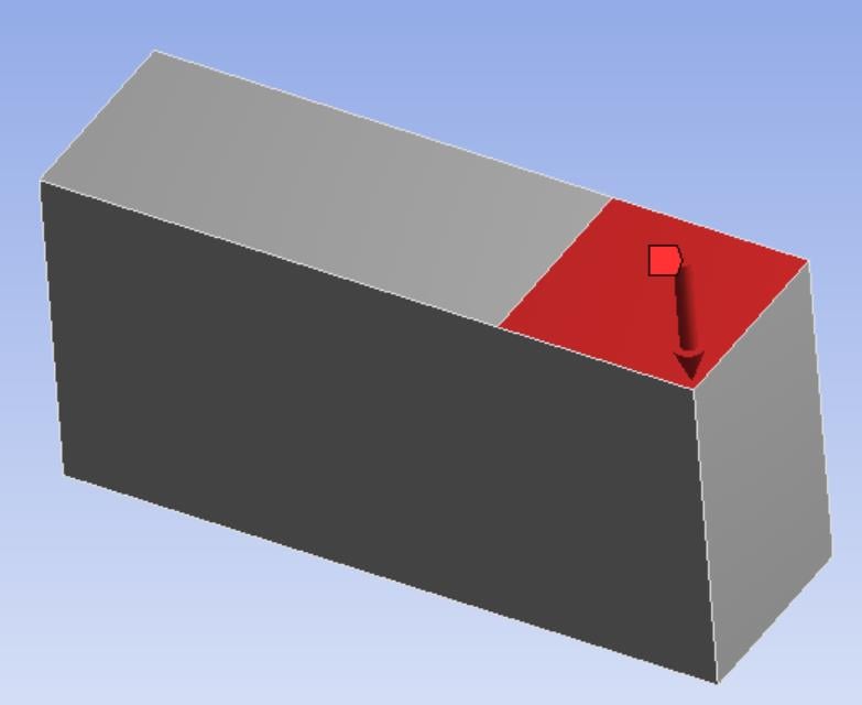

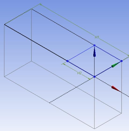

      My intention was to move the force area (30mm) from the one side to the other.  But even using DesignModeler i could not make it:
      Here is when d1=100mm (now d1 is measured from the right side of the rectangle:force area)
      And here is the result when d1=30
      The force placement is fail (same problem with Spaceclaim)...Is it possible to have fcp=0 and 100 (d1=30 and d1=100)??
      In the first DM model from earlier, you had the dimension like this:
      In the new model attached above you moved the dimension to the far side of the area. Don't do that.
      1) Is it possible to have fcp = 0 and 100?  The answer is no, because that introduces a topology change.  With fcp between 10 and 90, there are three faces on the top, at fcp = 0 there are only two faces on the top.  The same applies to hlp. If hlp = 0 the hole becomes tangent to the end and that may cause problems.
      2) Look at this graph, it shows that as fcp approaches 0, the stress suddenly increases. Why do you even want fcp to approach 0?
      3) You made no comment on the fact that for the dimensional limits provided that you can minimize the mass by simply setting L, H and t at the lower limit and r at the upper limit and as long as fcp > 2%, the model satisfies the stress < 125 MPa constraint.
