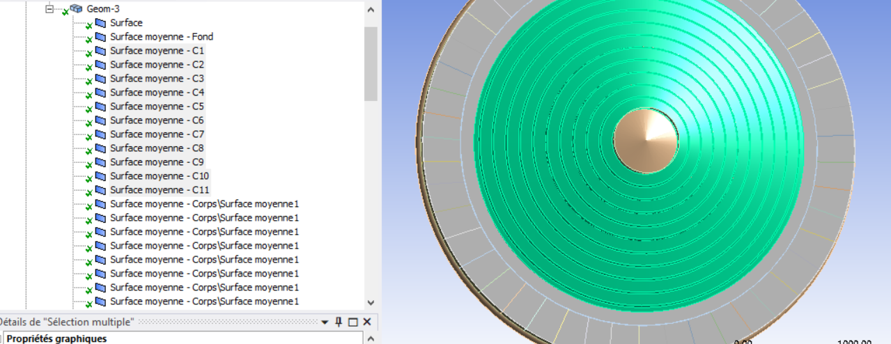

Subscriberhello @peteroznewman I wanted to do a parametric optimization on Workbench and I wanted to know is there is a way to group the input parameters as you see in the pictures the input parameters are the circuits and I wanted to play on the thickness value knowing that all the circuits have the same value of thickness and stroke instead of selecting 11 parameters and what there is a way for all its parameters becomes one parameter

SubscriberThe possible way is define all surfaces thichness as parameter and in the parameter table just enter the expression say the thickness of the first shell is thickness[P1]nthen you enter the all the other parameters to be =P1 or use the spaceclaim to define the parameter and link all others to via parameter name so you can control all thickness with one control in Parameter table.nCheers,nRamnFebruary 26, 2021 at 2:02 pmoumaimalahmar.ol
SubscriberThank you so much, I see how I'm going to do it.nViewing 2 reply threads- The topic ‘parametric optimization parameter’ is closed to new replies.
