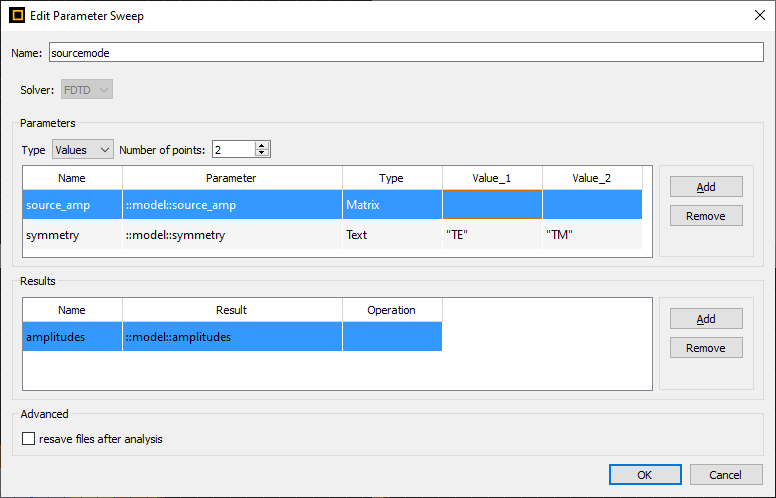

      Hi everyone,
      I am trying to set up a sweep in Ansys Lumerical FDTD where the parameter I want to sweep over is a matrix.
      There is an option to set the parameter type as 'Matrix', which I have selected.
      I have set the sweep 'Type' set to 'Values' (instead of 'Ranges' - I can not imagine a range of matrices, or text strings for that matter as well). My custom analysis group controlled by this sweep also accepts matrices of any size, so there is no problem there.
      However, when I then enter a matrix such as [1;2] for 'Value_1', the matrix is not accepted and the value is reset to 0. The same happens for any 'Value_i', also when using the addsweepparameter command to set up the 'Matrix'-type sweep parameter, including all values, simultaneously.
      Is this intended? Is this a bug? Is it a feature which is not implemented yet?
      Is there any other workaround except programming a 'custom' sweep with for loops, multiple files and parallel job execution?
      Thank you for your help!

      Attached, you can find some screenshots of the problem:
      This is the "model" analysis group - I want to sweep the parameter "source_amp". As you can see, it is a matrix parameter, and it is set to a 1x3 matrix at the moment.

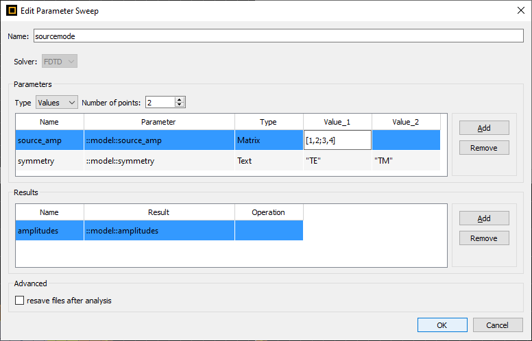

      Here, I am trying to edit the sweep with the 'source_amp' parameter from above
      As soon as I hit enter, I get this result: My matrix input is gone
      When clicking the value again to edit it, it shows 0 instead of the matrix I entered:
      When I save or run the sweep, I also find that my analysis group 'model' has its parameter 'source_amp' set to 0.
      I can not believe this is "in general desired". Is this a bug?
