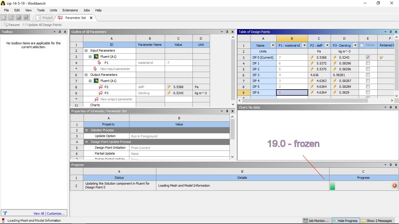

I am trying to adapt a fluent model parameter example from fluent and workbench 14.5. It is not working
for workbench 18.0 and 19.0.
Hopefully some ANSYS expert staff can solve my issue.
Let me describe:
1)The task is to set the parametric study involving different set of pre-defined fluid
materials. It uses a customized input parameter in Fluent.
2)It uses a prepared Fluent case. The case was set
with seven different materials representing air (air1,air2, … , air7) and every air
material is utilising a different density model available in the Fluent solver.
3) The simulation is being performed for a
number of different cases in Workbench(every case will utilise different density formulation)
I will describe my steps next and attach the pictures, .cas and .scm files :

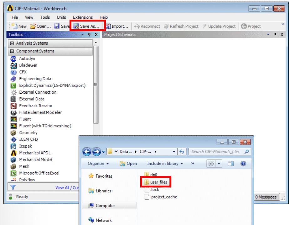

i) Started a new workbench session
• Saved the project as: ‘CIP-Material’
• Located the ‘user_files’ folder
associated with this project and
copy the .cas and the .scm file

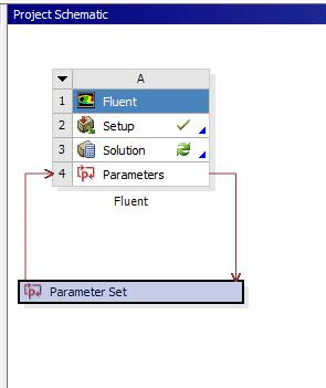

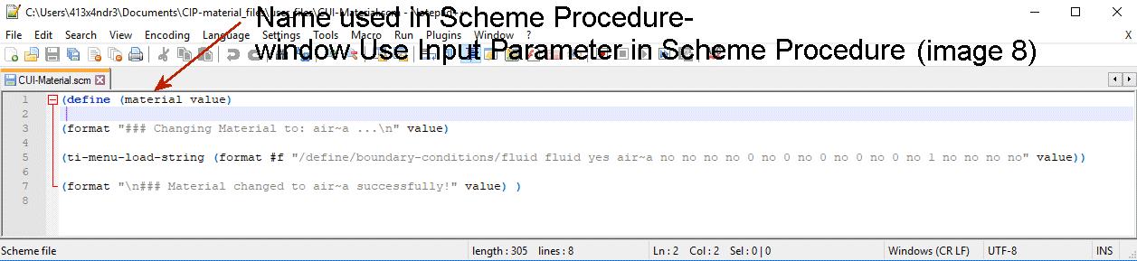

II) Dragged a Fluent component system
onto the project schematics
• Right-clicked on ‘Setup’, and selected
‘Register Startup Scheme File’, and
Browsed
• Browsed to and select the file
“CUI-Material.scm” located in
project’s ‘user_file’ folder
iii) Right-clicked on ‘Setup’, and selected
‘Import Fluent Case’, and Browsed
.cas file located in
• In the Fluent Launcher panel selected
‘Double Precision’ option and pressed
‘OK

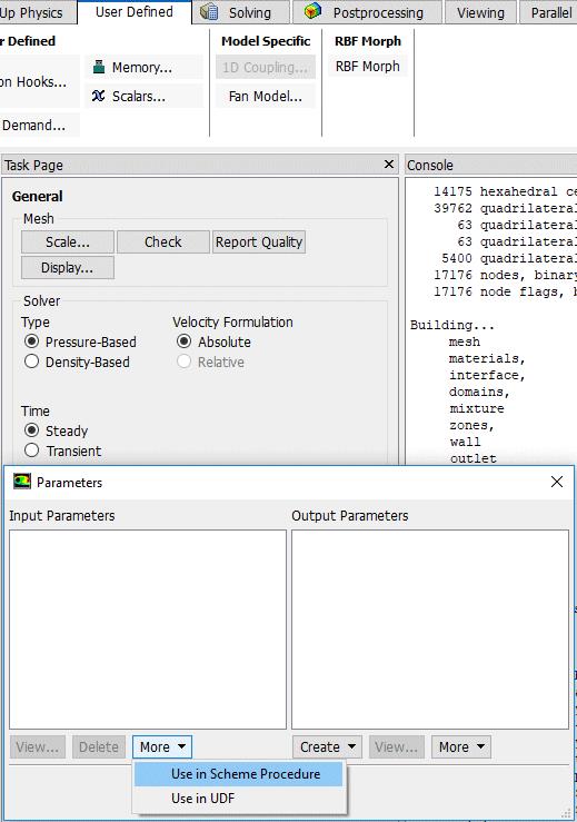

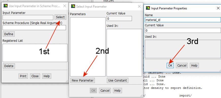

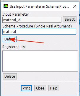

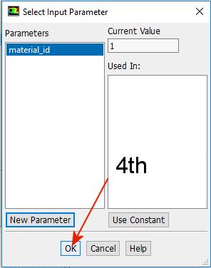

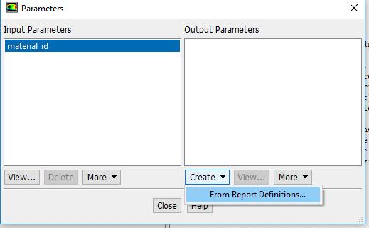

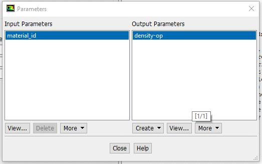

iV) In Fluent Text User Interface (TUI) typed the following
command: (material 1)
Verification of startup scheme was ok
v) Defined input and output parameter as in the following images

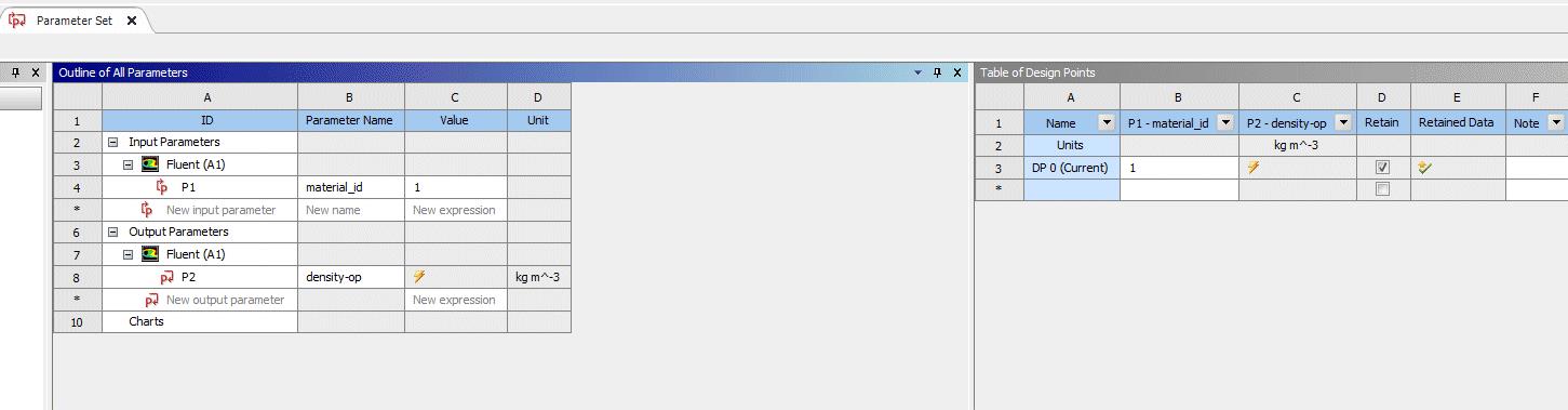

Forum ModeratorYou've only got one design point in the list, and the P1 is greyed out. I'm not sure you can change a material property as a parameter: you may need to use a different approach. Happy to be corrected if you can show the reference!
June 10, 2019 at 1:49 pm
ALEXANDRE COSTA
SubscriberHi
Thanks for the output. The reference is for version 14.5 (please see the first image, most of the images are also from the reference). It used a “create-custom-input-parameter” at the TUI (not available in the new versions, so I adapted that step
.It is working for just one design point each time(with fluent window opened) but not for a whole table of design points(fluent window closed). Clearly, the problem is in the comunication between fluent and workbench, but i am missing something. Very happy, if an expert help to find the solution. -
