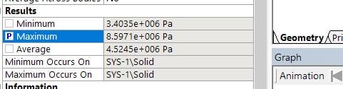

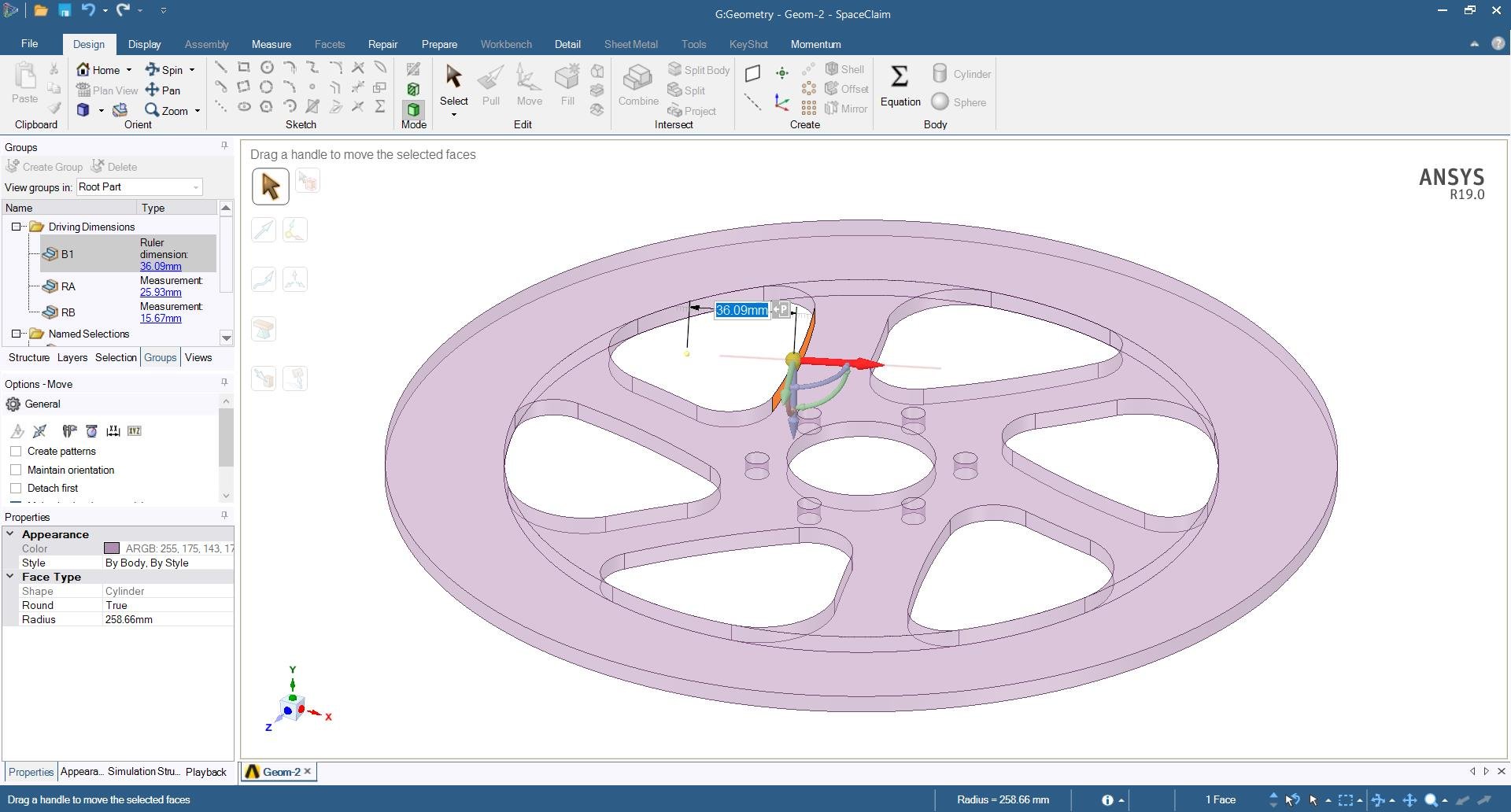

I have encountered problems at the time of setting up the OUTPUT PARAMETERS of a static structural analysis. Im intending to optimize the groove shave of a brake disc and i set up 3 groove parameters in SpaceClaim. When in Workbench (Mechanical), as soon as i set the "Equivalent Von Mises Stress" as parameter, a message pops out stating "An unexpected error occurred: No system is associated with the component Setup 1".

Image: Geometry parameters

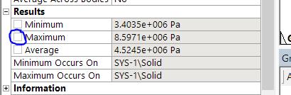

Image: One of the desired output parameters
Image: Error
Image: updated, appears as parameter but it doesnt work

SubscriberHello, I've been having the same problem. Was doing eigenvalue buckling simulations (among other things) and had a few load multipliers of modes of buckling as output parameters. Was working fine, was able to change the geometry as parameters and recieve the output parameters. But then i wanted to change which mode of buckling was an output parameter and i started getting this error.
