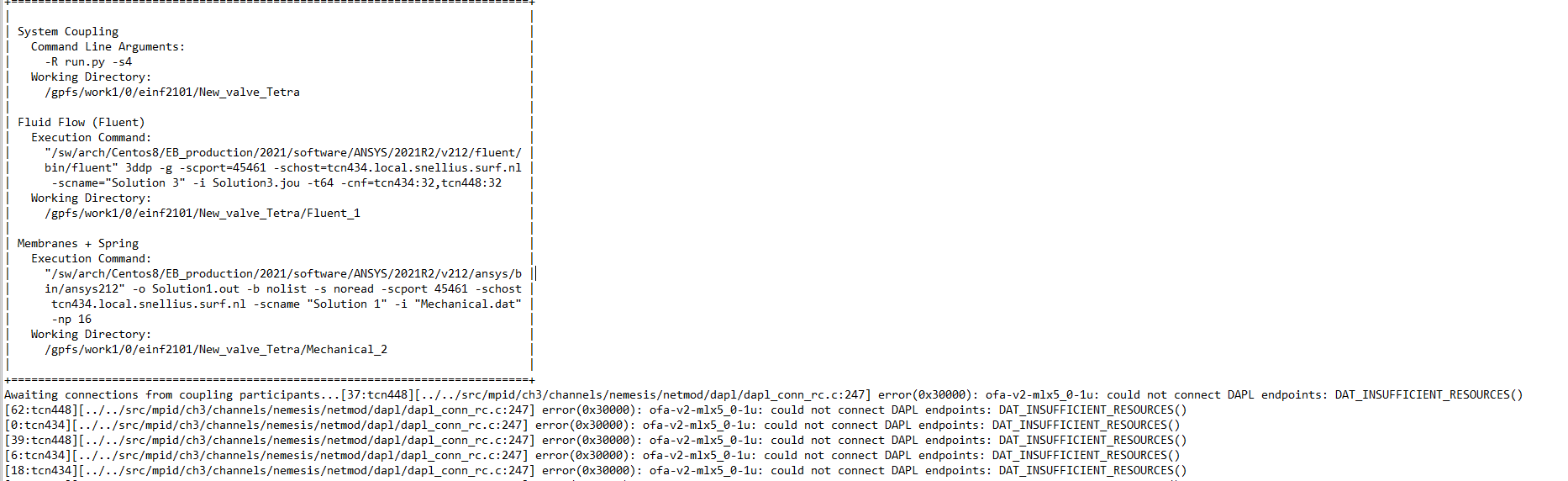

I've been doing FSI simulations using Ansys SystemCoupling for quite some time now. Currently, I am using Surf Snellius supercomputer for my heavy duties with Ansys version 2021/R2. Although my simulations require extensive computational power, I am suspicious about my actual computational runtime and believe I can reduce it further. An example concerns a two-way strongly coupled simulation of a microfluidic valve interacting with a soft incompressible membrane to allow/block the flow.Â
Typically, I restrict myself to +/- 1Million PUMA-type cells from Fluent perspective and ~50K SOLID285 elements for transient Mechanical. The problems also include contact, gap modeling and require careful attention to avoid floating point exceptions and divergence events.Â
Now, I encountered an issue while trying to run the simulation using multiple nodes, and I am sharing the error I get from the SyC log for your consideration: While trying to sbatch on multiple nodes, the Slurm job does not fail, but the simulation gets stalled instead.
I am not an expert on parallelization, but I think it has something to do with the MPI. In fact, I remember I had to export a command to enable FSI simulations using one node and multiple cores as follows:Â
export LD_PRELOAD=$EBROOTANSYS/v212/commonfiles/MPI/Intel/2018.3.222/linx64/lib/libstrtok.so
The Slurm batch file is fine and consistent with the one proposed in the ALH SyC course. The issue emerges as soon as I run on multiple nodes.Â
Although I tried some suggestions from different discussions, such as this one: /forum/forums/topic/fluent-2021-r1-running-on-a-linux-server-has-issues-with-intel-mpi-2018/, the problem persists, and I could not find a way to solve. it.Â
I am looking forward to your suggestions.
Thanks a lot,Â

Following the previous thread (which, unfortunately, was not resolved), I wanted to share additional information that might help create a workaround for my problem. I am sharing with you these few lines of a batch script that I wanted to run on 2 nodes for your consideration.Â
FLUENTNODES="$(scontrol show hostnames)"
FLUENTNODES=$(echo $FLUENTNODES | tr ' 'Â ',')
$ANSYSROOT/SystemCoupling/bin/systemcoupling --cnf="$FLUENTNODES:16" -s4 -R run.pyÂ
The job runs for less than a minute, and by looking at the Slurm queue I could see the assigned nodes but then the job fails,, and the log file shows the error message: "RuntimeError: Compute nodes did not start properly".Â
I am looking forward to your cooperation,Â
Best regards,Â
