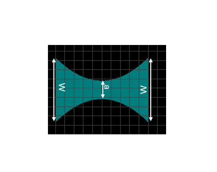

I am trying to draw a structure like this as an SWG width as W and a in the middle. May i know how to do this with a custom structure as a lumerical script.How do i describe this in the code? Is it possible to get a sample code for this arrangement?

I have this code but needs to be arranged in parabolic shape as shown above. How can i modify this

Thank you for reaching out to us! We have this object in our libery and there you can see the equation that is used to be built:
I believe that if you use the script commands, addcustom - Script command, you will be able to built this structure.
