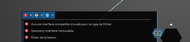

      I try yo open in Discovery, SDAC and  SDPC file format and i get this error :
      Have you an idea ?

      Hello GUICAD ,
      If it's possible, can you please share the files? I will check it at my end and get back to you.
      Thanks and Regards

    • Atharv Joshi
      Hi GUICAD ,
      Do you have Creo installed on your machine? If its installed, then it should be able to import in Discovery Successfully.
      If its installed, then please check CAD configuration from the following path.
      Start Menu>> Ansys 2023R1 Folder >> CAD configuration Manager >> Check Creo Elements/ Direct Modeling >> Move to CAD Configuration >> Configure Selected CAD Interface.
      Then try importing files in Discovery. Let me know if you face any issue.
