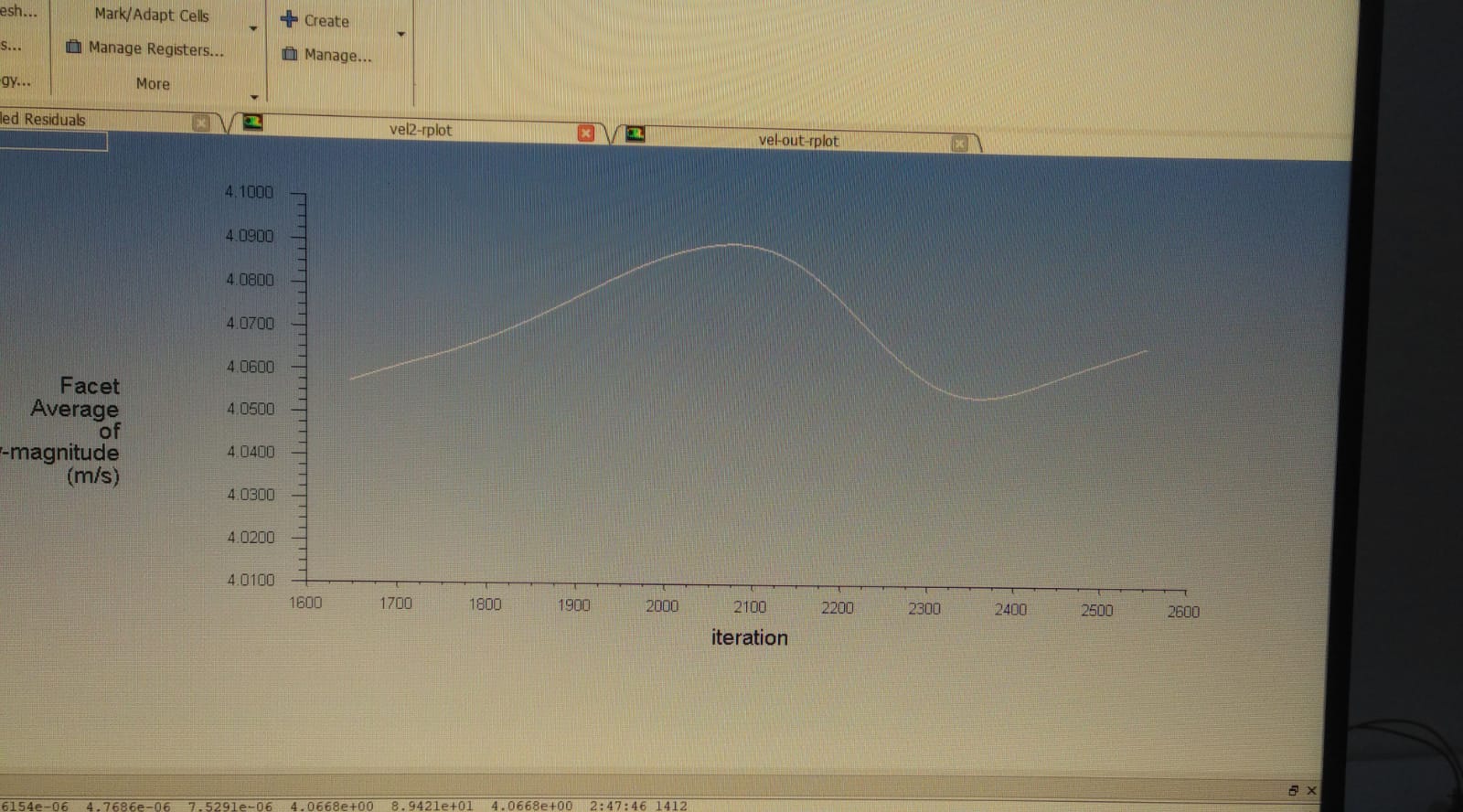

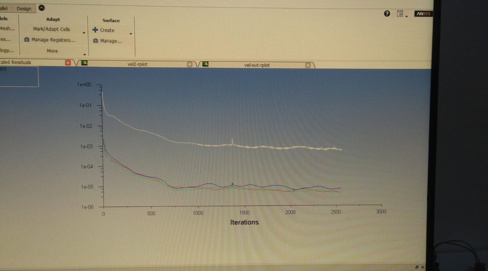

SubscriberHi, i'm trying to simulate flow over a cylinder (von karman effect) with steady laminar flow. Residual do not converge but oscillating. I was wondering if the problem is a wrong setting in the solver, bad quality mesh or that i'm trying to capture an instant of an highly unsteady flow with a stetady solver.
 Can someone clear my doubts?
thank you

Forum ModeratorIf the residuals dropped to around 0.01 or so and they're showing something like a sine curve you've probably picked up the transient.Â
https://www.youtube.com/watch?v=nmvEyeOGgqI
If you post images (please post using the icons in the editor rather than attaching) of the mesh, residuals & result we can give a more informed answer.Â

Ansys EmployeeWith steady solver you are not capturing any unsteadiness but just a snapshot of the flow.

Subscriberok, i 'm capturing a snapshot at T = infinity. Since RANS are avg in time to remove oscillations. If the flow is symmetric i get a beaufiful resuls. ùbut in this case, flow behind the cylinder is not symmetric, what snapshot should i get?

Ansys EmployeeSomething unreasonable from physical side in nutshell. It is per maths as the steady solver will just point to one of stable modi if the run.
