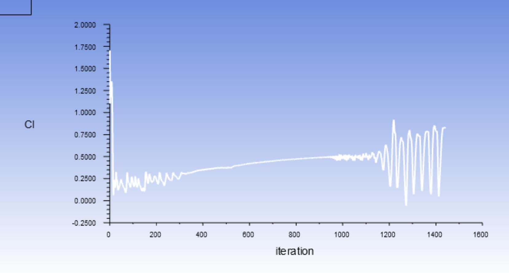

      I am simulating flow around 2D hydrofoil in ansys fluent.
      I am doing this for various angle of attacks between 0 to 20 degrees. the results are ok until 12 degree but after that residuals and lift and drag coefficients plots became oscillating. how can I solve this problem?
      for more information:
      the model is k-epsilon (realizable and standard wall functions). scheme is coupled and gradient option is green-gauss cell based. pressure, momentum, turbulent kinetic energy and turbulent dissipation rate are chosen second order.
      screen shots of oscillating plots are uploaded below
    • Kalyan Goparaju
      It may be that beyond 12 degrees AOA, the flow is separating and could also be shedding. That may be the cause of the unstable/oscillatory behavior of the residuals and the force monitors. Such a condition is heavily transient and you should consider switching over to an unsteady simulation.
