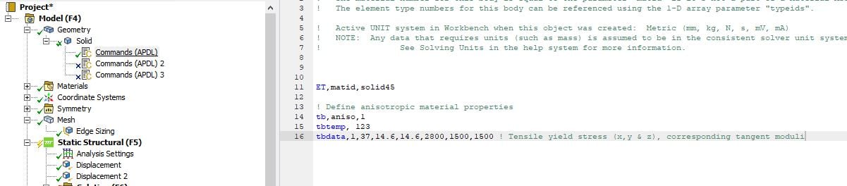

SubscriberI have tried to apply (TB, ANISO) command in Ansys workbench. It doesn't work. Always shows the below error message.Â
I added the below command snippet in the geometry section. I added tensile yield stress with a corresponding tangent modulus of x,y & z direction. Can anyone help me to find out where I made a mistake?

Ansys EmployeeHi,

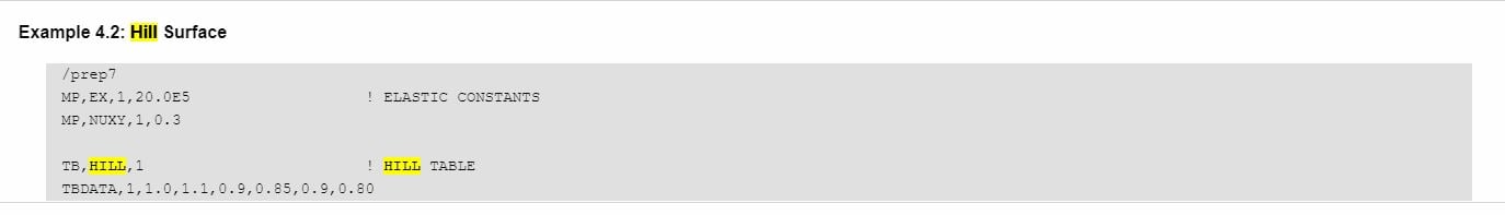

TB does not have an "ANISO" material model name. You need to use a valid material model name defined here:Â https://ansyshelp.ansys.com/account/secured?returnurl=/Views/Secured/corp/v201/en/ans_cmd/Hlp_C_TB.html?q=tb
Hills yield surface allows you to define an anisotropic yield surface, but it won't let you define anisotropic tangent modulus. Please check this page for your desired material model. https://ansyshelp.ansys.com/account/secured?returnurl=/Views/Secured/corp/v201/en/ans_mat/amp8sq21dldm.html%23matRIPisohillyield. Below is an example of how to use TB, Hills

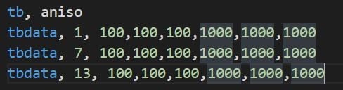

lincs2k9
SubscriberThank you for giving your time. I have also checked that issue. Problem was that I defined only tensile yield stress and tangent modulus.
Another question is-
In your previous reply you said that it is recommended to use newer technologies. Is there any new alternative in Ansys except TB, ANISO?
I asked that because I found that TB,ANISO doesn’t support temperature dependent material property. But I have to add various direction yield stress, tangent modulus based on different temperature. -

Wenlong
Ansys EmployeeThere is Hills anisotropic yield criterion, however, I am not aware of an anisotropic hardening model. The available material combination can be found here:Â https://ansyshelp.ansys.com/account/secured?returnurl=/Views/Secured/corp/v201/en/ans_mat/elemamoco050301.html?q=anisotropic%20plasticity, you can see from that page that all the available hardening law is either isotropic or kinematic.
