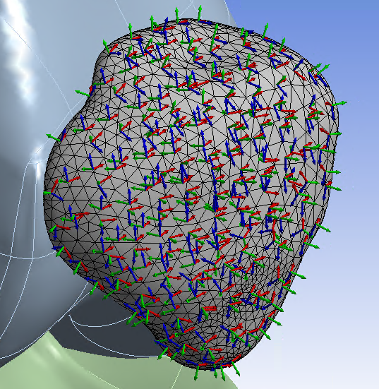

I have been trying to find a workaround for the problem, using the element orientation in mechanical (Geometry→Modify→Element Orientation), which visually (pictured below), at least, seems to be an alternative to the ACP-proces. However, I can't figure out how to link the element orientation with the orthotropic material properties of the cortical bone.
- Is there a way to do this or any alternative measures for ensuring proper orientation of the orthotropic properties? (2021 R2)

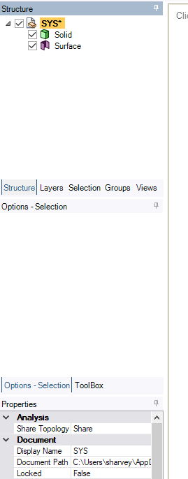

In edit the geometry in spaceclaim, pick the surfaces you wish for that material, and issue ctrl-c, ctrl-v. This makes a surface body of the solid faces.
In the tree, pick the parent component (in this case sys as shown) and then in properties change the share topology to Share
Now when you open in Mechanical, the surface and solid mesh will share nodes. Since you likely have a lot of tri shaped elements you want to use quadratic for the element order, so under mesh, change the element order to quadratic. Lower order tri elements are overly stiff.
You can now specify the element orientation to that surface body. Be careful not to assign to the face of the solid. Then verify the orientation using the results, coordinate system, element triads scoped to that surface body.
