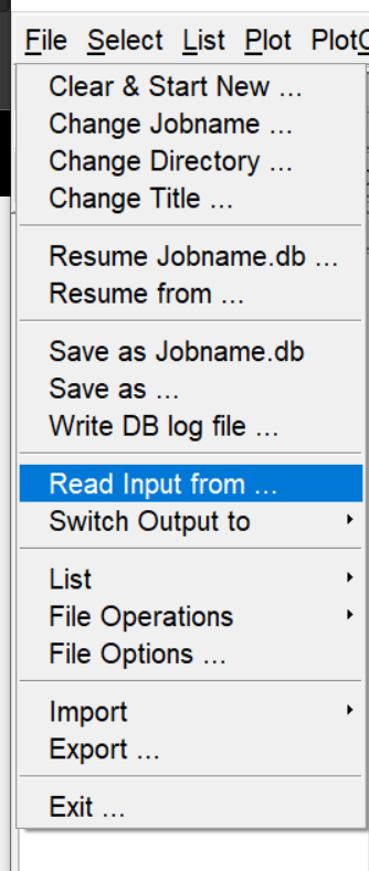

      Just write a .txt file with the commands you usually enter in the Command Prompt and save. Remembering to insert the command /PREP for the preprocessing phase, /SOL to calculate the solver card and /POST1 for the Postprocessing.
      To use it, just open a new project and then File > Read Input from… and select the .txt file.
      I attach a photo
