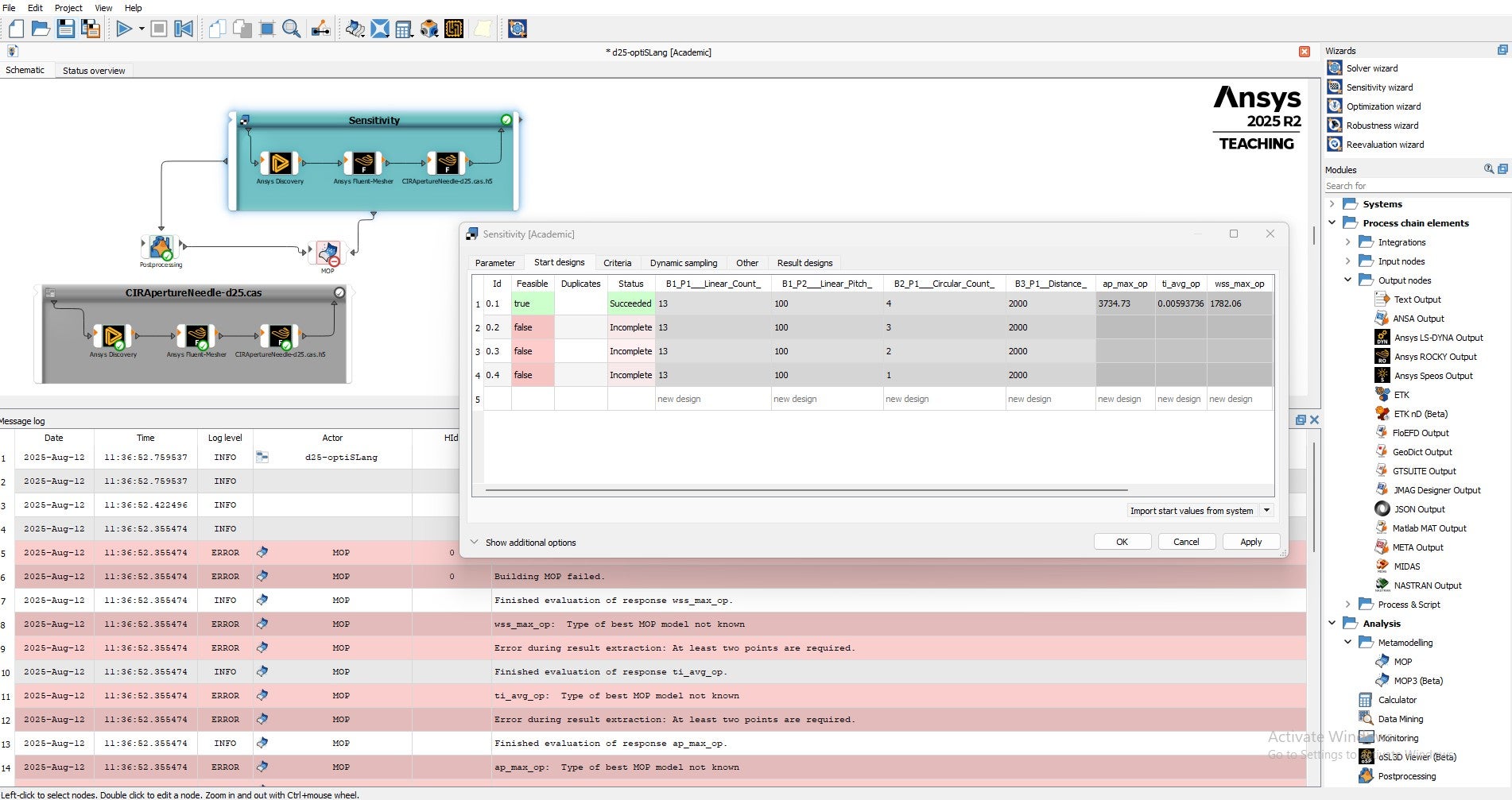

    • kocharti
      Veit,
      I tried with few samples . Good that CSV uploaded but the result is as you see in the screenshot. Regards, Ted
    • Veit Bayer
      Which versions of optiSLang, Discovery, Fluent etc. are you using?
    • kocharti
      All are 2025 R2

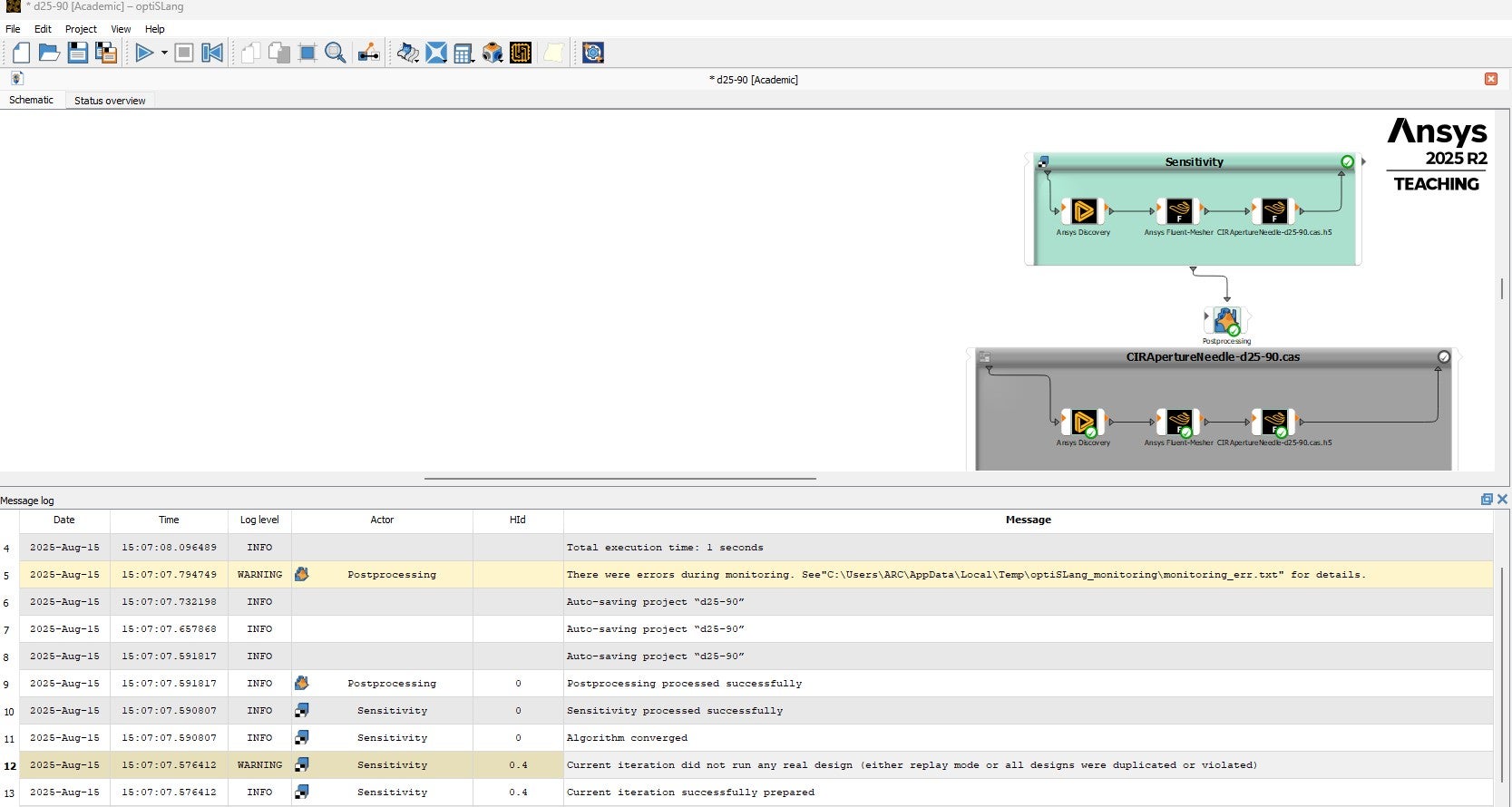

    • kocharti
      Please seed line 12 for the error message.
    • Veit Bayer
      Please edit the Sensitivity System. Go through tab by tab, unfold any sections/hidden settings, make a screenshot. Post the screenshots of all tabs here. Only then I may be able to analyze what you did. Thanks.
