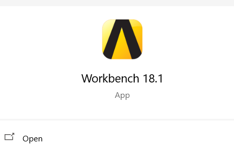

opening .wbpj (ansys project) of same version showing “project was saved in future version”.. help!!
TAGGED: ansys-student, ansys-workbench, maxwell, mechanical, workbench
October 14, 2021 at 5:30 pm
Kiran_333
SubscriberOctober 14, 2021 at 8:56 pmpeteroznewman
SubscriberSomeone saved this file in a version newer than 18.1 so you can no longer open it with 18.1. Look for a backup copy of the file.
October 15, 2021 at 3:53 amKiran_333
SubscriberBut it is showing that in file type it belongs to same version.
October 15, 2021 at 12:20 pmpeteroznewman
SubscriberIf all you have installed on your computer is 18.1, all Ansys files show as an 18.1 file, no matter what version saved the file last.
If I put that same file on my computer with 2021 R2 installed, the same file will show as a 2021 R2 file. That is Windows assigning file types based only on the characters after the period in the file name.
October 15, 2021 at 5:01 pmKiran_333
SubscriberOh okay . Great help!!! Thanks lot..
