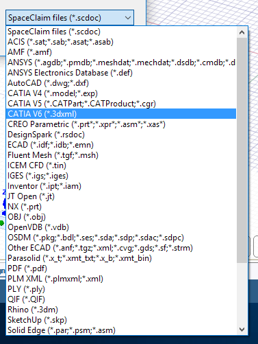

      Is it possible to open 3dxml file format with SpaceClaim or AIM ?
      Thanks,
      Guillaume
    • Naresh Patre
      Hello GUICAD
      While opening a new file, the 3dxml file format (CATIA V6) is already available in SpaceClaim list of file formats. See below snapshot.

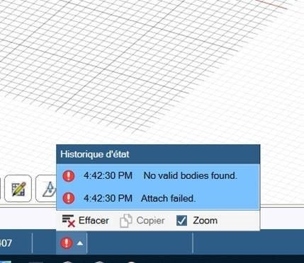

    • Guillaume ANFOSSI
      Hi Naresh,
      I try to open it but i get an error message.

      • Naresh Patre
        GUICAD
        After consulting with development team, I have submitted a defect for this issue. Below are the defect details for your reference:
        Defect Title: 3dxml file won't open in SpaceClaim
        Defect found in Release: R19.2
        Defect ID: DE180827
        As a workaround, you can export V5 file format (CATpart) or other netural files formats like stp, x_t, as available and proceed.
      • Naresh Patre
        Hello GUICAD I have got following update from development team regarding this defect DE180827 (3dxml file won't open in SpaceClaim):
        It appears that the 3dxml files were NOT exported with "Authoring".  Please note:
        The CATIA V6 Reader has the following limitations:
        Only supports CATIA V6 - 3DXML with Authoring  ?  There are two types of 3DXML files which can be generated and exchanged. The ?3DXML with authoring? (which include the export of geometry and meta-data) is supported by the CATIA V6 Reader. The ?3DXML for review? is not supported by the CATIA V6 Reader.
        In version 2019R2 (R19.4), a warning message will be added to help users understand why no bodies were imported: "Warning file does not contain authoring data"
