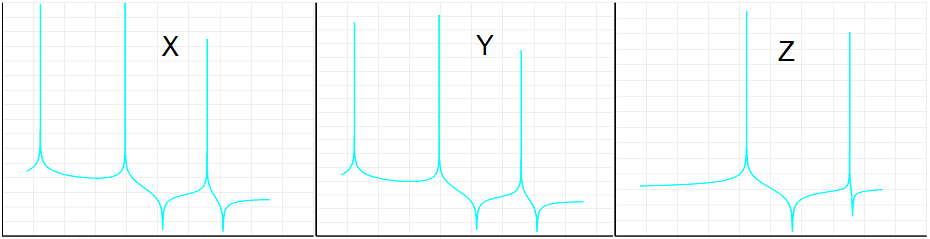

      I'm trying to find the frequency response of a structure that is subjected to accelerations in x-, y-, and z-direction, respectively. Using Full Harmonic gives satisfying results but computational times are too long which is why I want to switch to MSUP. I know from solution #855002 on the Customer Portal that the required required must extend past the range of interest. I'm interested in the first 6 modes and work with the first 200 modes. The only matching result from MSUP is in z-direction. The first image below is from the Full Harmonic and the second from the MSUP analysis, both show displacements.

      Post-processing is done in /post26. I'm getting the displacement using the NSOL command.
      I would like to know why there's no response in x- and y- direction when using MSUP. How must the code be changed to solve this problem?

      In the modal analysis you create 3 load vectors. But looks like you have only one load vector created in the Z direction. Can you rerun the modesup harmonic with lvscale applied to only load vector 3. I wonder if load vector 3 even exists.

      The picture in my original post should be the result of load vector 3. The way I structured my analysis is as follows (I probably didn't made that clear enough before):
      • Modal analysis and creation of three laod vectors
      • First MSUP analysis with subsequent post-processing using first load vector:
      lvscale,1,1
      lvscale,0,2
      lvscale,0,3
      • Second MSUP analysis with subsequent post-processing using second load vector:
      lvscale,0,1
      lvscale,1,2
      lvscale,0,3
      • Third MSUP analysis with subsequent post-processing using third load vector:
      lvscale,0,1
      lvscale,0,2
      lvscale,1,3
      Each MSUP analysis is started by issuing a new /solu command and closed with finish. This way all three load vectors should be used except, of course, they weren't created in the first place. But I used this evaluation scheme on other models and there was a response in x- and y-direction (both for MSUP and Full Harmonic).
