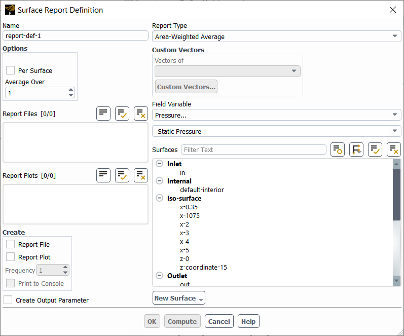

      Hi! I would like to measure a particular parameter at various points. However, when I highlight all points in one report definition I got in the report an average value from all of them, instead a value for each point separately.
      Do I have to do a report definition for each of these points separately (there are many of them) or is there a way to highlight them all and then some approach to extract data and get results for each particular point? I hope that it's clear ?
      You'll note the "Per Surface" in Options. Try that.
    • Lucy
      It solves the problem! Thank you Rob!
