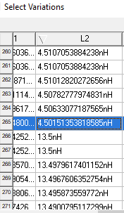

SubscriberI remember this bug as long as I work with HFSS, starting from ver.11, and no one ever tried fixing it.
The parameter sorting splits at the next order and flips the opposite way, so you get 9,8,...1, (!) 99,98,97,96,95...11,10.

June 24, 2021 at 10:19 amAndyJP
SubscriberThat is a list of solutions from the solution list.
But the problem is omnipresent in every table: the quantities a sorted correctly only within the same order (of the integer part). The next order of the quantity does not follow the sorting order(direction):.
In the decrease-sorted example above, the higher order of the numbers is appended to the tail, instead of going in the head of the list.
In every version of HFSS I ever seen. I was surprised to find it again in 2021R1.

Best regardsJune 30, 2021 at 12:37 amAndyJP
SubscriberIt is not in the sweep definitions. It is in the results. When you simulate a number of iterations, you have every iteration recorded with the parameters. And sorting by these parameters does not work as expected when the variation is larger then one order. This makes it very hard to find the iterations of interest.
