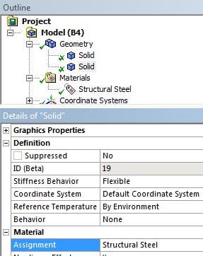

      i have attached my model with this, as i am new to ansys kindly ignore the mistakes if there is any. I been Ansys workbench 18.1 for the modelling, Please respond. Thank You

      The two solids are assigned to be Structural Steel. Create a Concrete material and assign that to the inner solid. The material has to have some failure mechanism added because all you have is a linear material and that never fails. For the concrete, the Microplane method is recommended.  For the steel, you have to add Plasticity. A simple model is Bilinear Isotropic Hardening. In that model you just need the Yields Strength and the Tangent Modulus.
