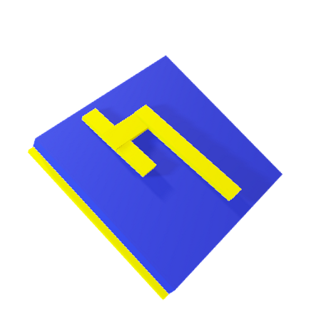

      The link you provided is what I used for the extraction of the S parameters in my design. For the question you asked "Is your structure symmetric for s and p polarization?" I don't know how to determine if it's symmetric for both polarizations. Below is the picture of the structure. Thanks for your response
    • Guilin Sun
      This structure is not symmetric in any sense, thus s and p results will not be the same. In the textbooks it is the planar, thin film type, which has symmetry so the results are the same.

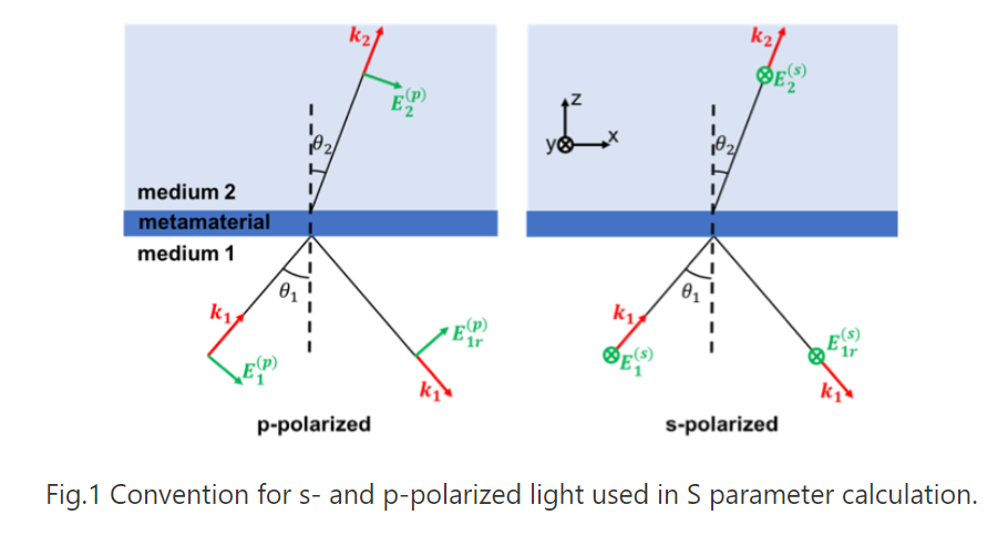

      How can I obtain S parameters for my structure for both s and p polarizations?
      Do I need to change polarization angle to 90 degree for p and 0 degree for s based on this convension?
      source of Fig1: https://optics.ansys.com/hc/en-us/articles/360042095873-Metamaterial-S-parameter-extraction
