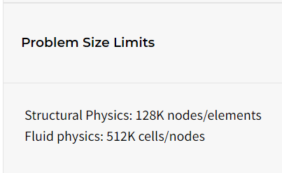

      For the latest student version, the number of allowed node count is 128k.

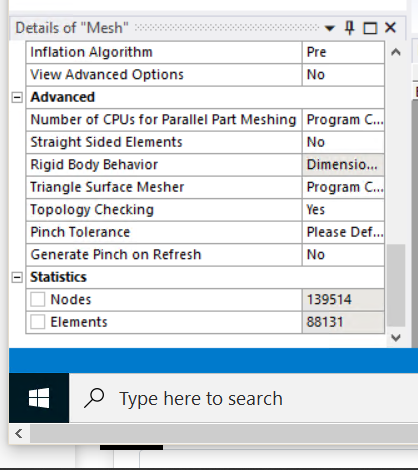

      Thank you Mr. Ashish Khemka, but if the limit is 512k, then what should I fix from this error??

      My apologies, for Fluids the limit is 512k and for Structural analysis it is 128k.

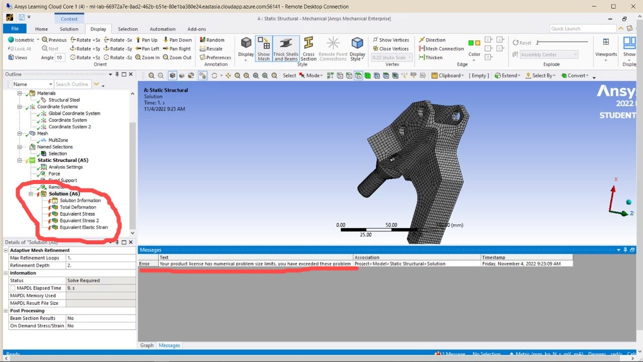

      Permission to ask again Mr. Ashish Khemka, I have tried changing the total nodes/elements with mesh numbering and it didn't work, so can you please tell me what is the other solution of this problem??

      I have tried before, but still can't, after that I try to analyze from the beginning but the result is still same, still can't
      I want to say that I use the Ansys Cloud, not the application

      Right-click the Mesh object and chose to "Clear Generated Data".  The left-click the Mesh object to activate it; then down in its Details menu change the "Element Order" from Program Controlled to Linear.  Now mesh again and check the node/element count.  Should each be less than 128K and can now solve.
