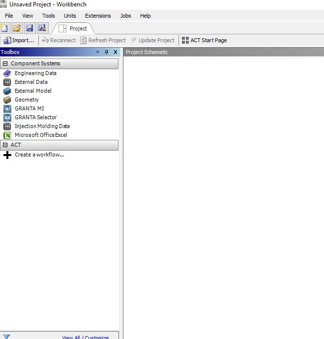

Not seeing any items in the ANSYS Workbench toolbox?
    • pgl
      After reinstalling ANSYS Student 18.2 recently I also ran into the issue that some have reported that Workbench opens up with no toolbox items. I initially thought it was an installation problem or license access problem. In my case I found that the UI had launched in a custom view mode, hiding what I was expecting to see. My problem was solved by selecting View > Reset Workspace

    • Jorge1998
      hello, if someone can help me i appreciate so much. My problem is when i open the Ansys Students the toolbox dont have the analysis sistem, just appeared component systems and ACT. I checked the firewall of windows and it´s ok, but i think the problem is relacionaded with the license.

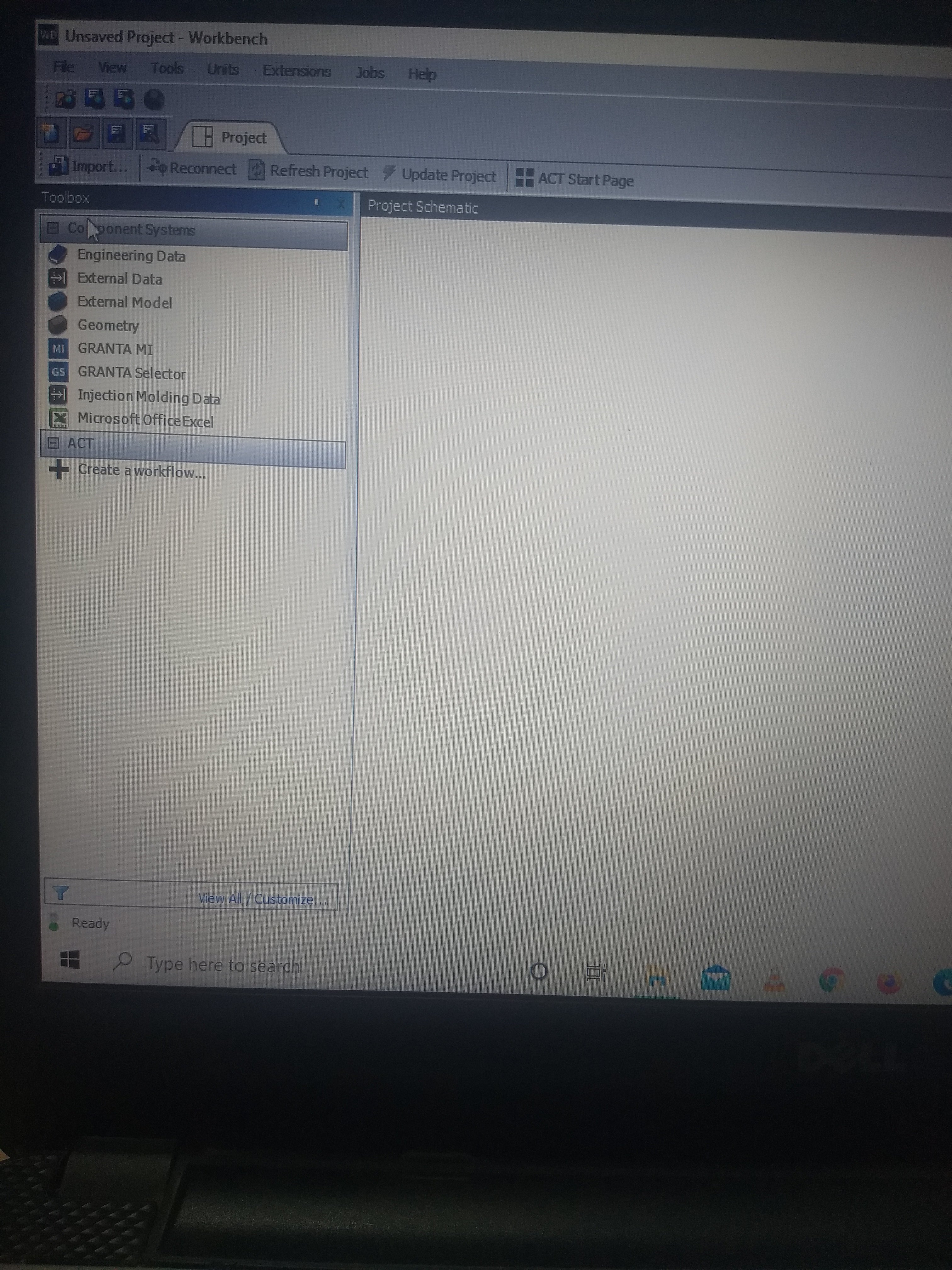

    • GSR30
      Ansys 2020 R2 mechanical workbench layout is not visible clearly..... it was viewing right after the installation, I don't know where the error is.. How can I change it to normal? Please help me. nn
    • Gabriele Picerni
      Hello Everybody! I also had the same problem: once the software was installed, the toolbox resulted to be almost empty with all the icon missing. I solved the problem after many days playing with licence right. I am trying to install it again but I still have the same issue. Moreover, the workbench icon is grey but all the downloading procedure was carried out properly I am sure. I hope someone out there has a solution.

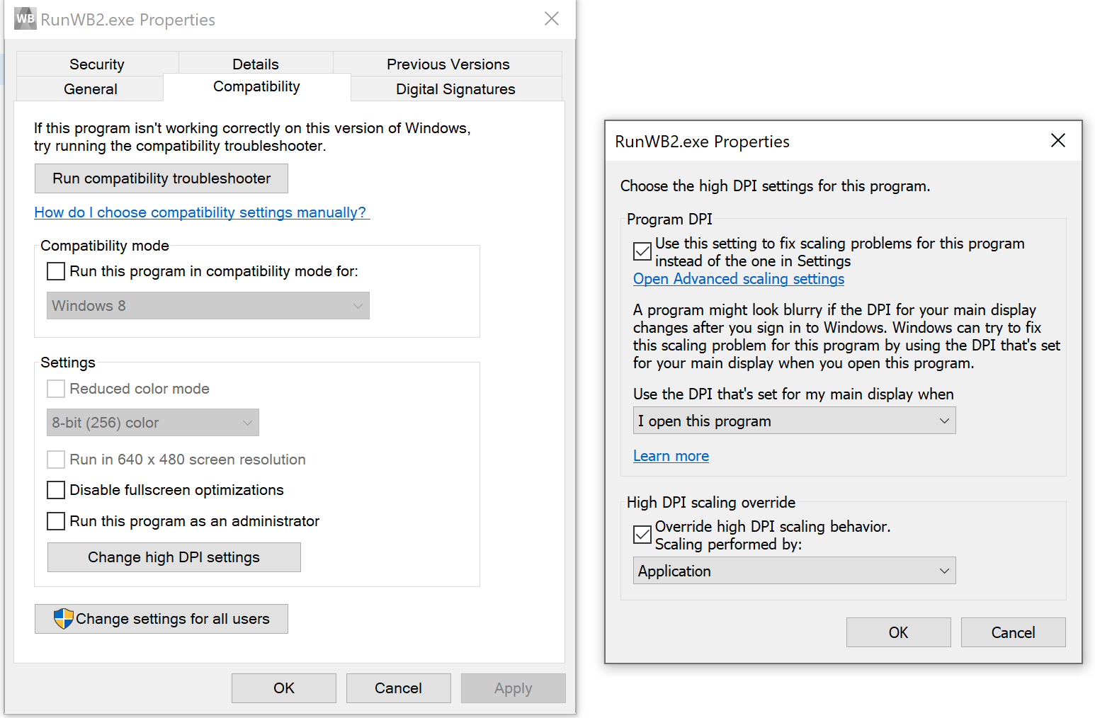

    • Muhammad Sharjeel Chawla
      You can fix this problem by going to workbench file location. Right click on the icon and select properties. Select compatibility and change high dp settings. Then select override high dpi scaling and dropdown the arrow to select system (enchanced) option. Restart the workbench :)

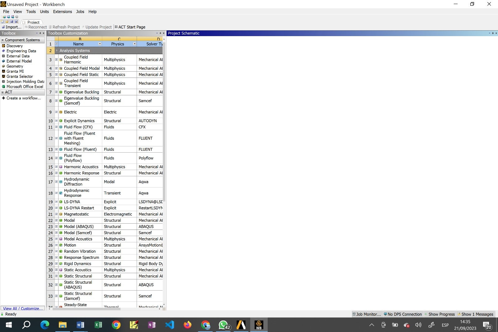

    • Mariah Carey
      Another solution that I've found useful is to right click on an empty space in the toolbox area and select "Customize Toolbar". Then in the "Toolbars" tab, make sure that the "Standard" and "Custom" checkboxes are selected.

    • MERCEDES CABALLERO GARCIA
      Hello, any solution to this problem, i tried everything you said in this post and nothing has worked. Why Analysis Systems are not added to the toolbox, how can I do it?
