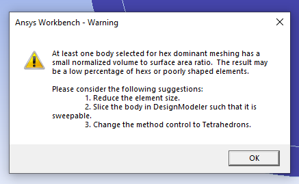

October 26, 2022 at 1:50 pm
Lovisa Svanborg
SubscriberI get a message saying that a recommendation could be to have tets. No other reason. No small features. I will course the mesh.

October 26, 2022 at 1:53 pm
October 26, 2022 at 1:58 pm
mrife
Ansys EmployeeHi Lovisa Svanborg
Just how thin is the plate compared to the diameter? Perhaps a shell FEM would be appropriate. Mike
