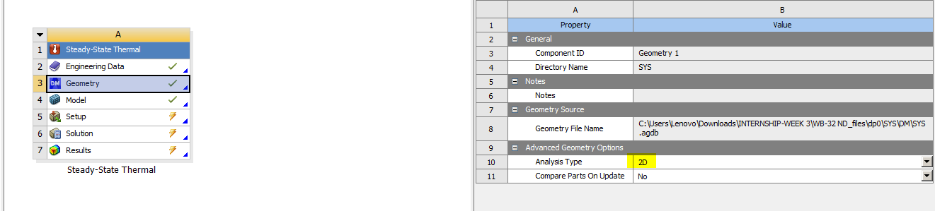

SubscriberEven though I have set a 2d analysis and just created a 2d surface for analysis in mechanical module its asking for thickness. Can you guide me how to pri=oceed the simulation just with a surface

SubscriberRespected Sir I had also done similarly instead of design modeler just used Spaceclaim but in analysis they are asking for thickness.Also analysis option such as axissymetry isnt being compatible for this analysis

Ansys EmployeeIt is fine you can have a 1m thickness the results will be in the xy plane (so 2D) and not vary in the z -direction - so that is the way to use it.
