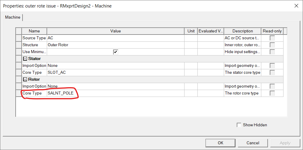

I AM TRYING TO CREATE IPM SYNCHRONOUS MACHINE WITH OUTER ROTOR STRUCTURE. INITIALLY RMXPRT MENU SHOWING BOTH OUTER ROTOR AND INNER ROTOR OPTION IN STRUCTURE. AFTER SELECTION OF OUTER ROTOR IN STRUCTURE THE OPTION FOR MAGNET DIMENSION CONVERTED TO WINDING IN ROTOR SECTION. IF ANYBODY HAVE ANY IDEA ABOUT THIS, PLEASE HELP ME
January 12, 2022 at 11:08 amNKC
Forum ModeratorHi @mitul After you change the structure to the outer rotor and close the window. The core type will also change to default Slot_AC.
Change the slot type to SALNT_POLE to get back to magnet dimensions in the rotor.
Regards Navya

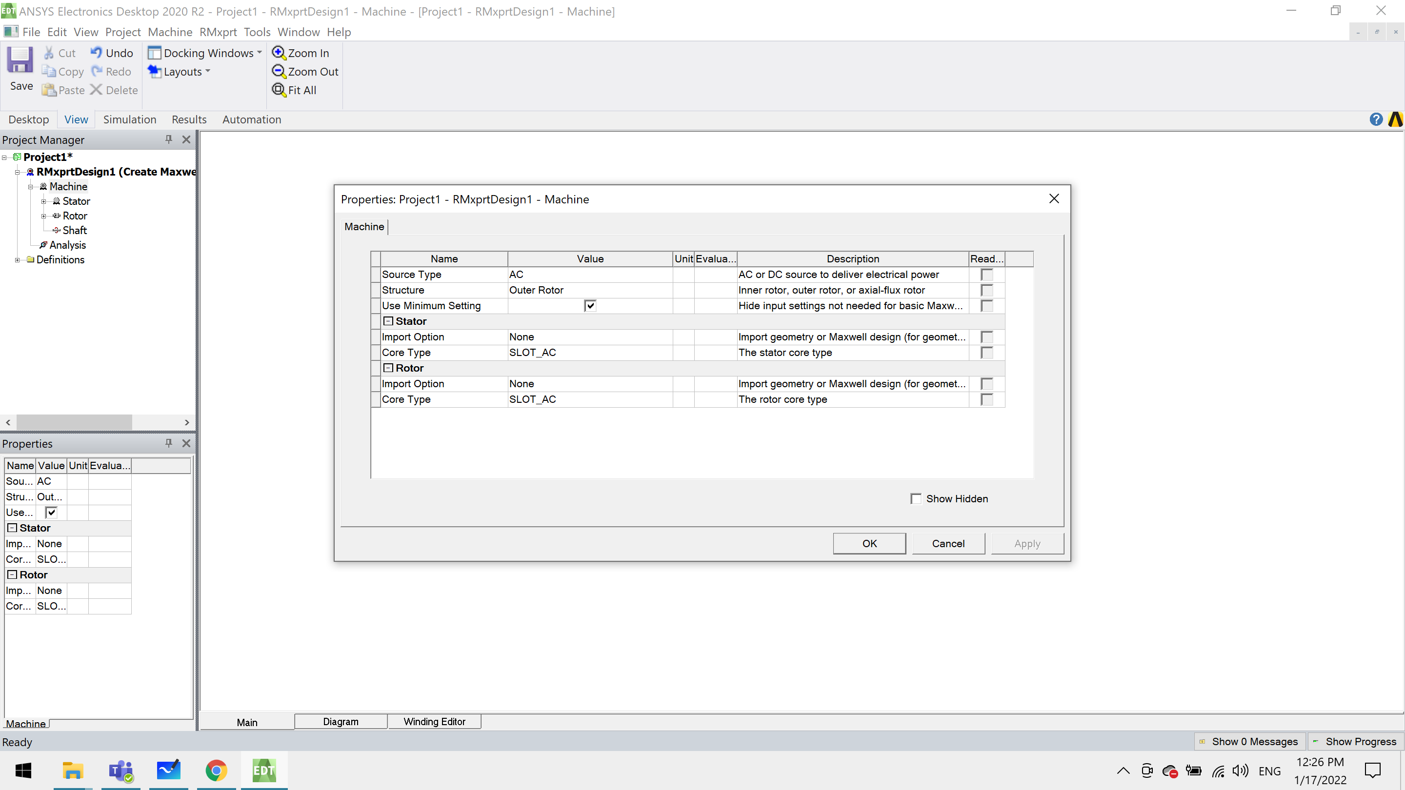

But, I am talking about IPM synchronous machine. In rmxprt outer rotor and inner rotor options are there. When I select outer rotor type of rotor changed to wound rotor. I have tried your suggestion and it is again wound rotor pole salient pole. I think IPM is for "insert permanent magnet ". I need help to create rmxprt for IPM outer rotor synchronous machine.

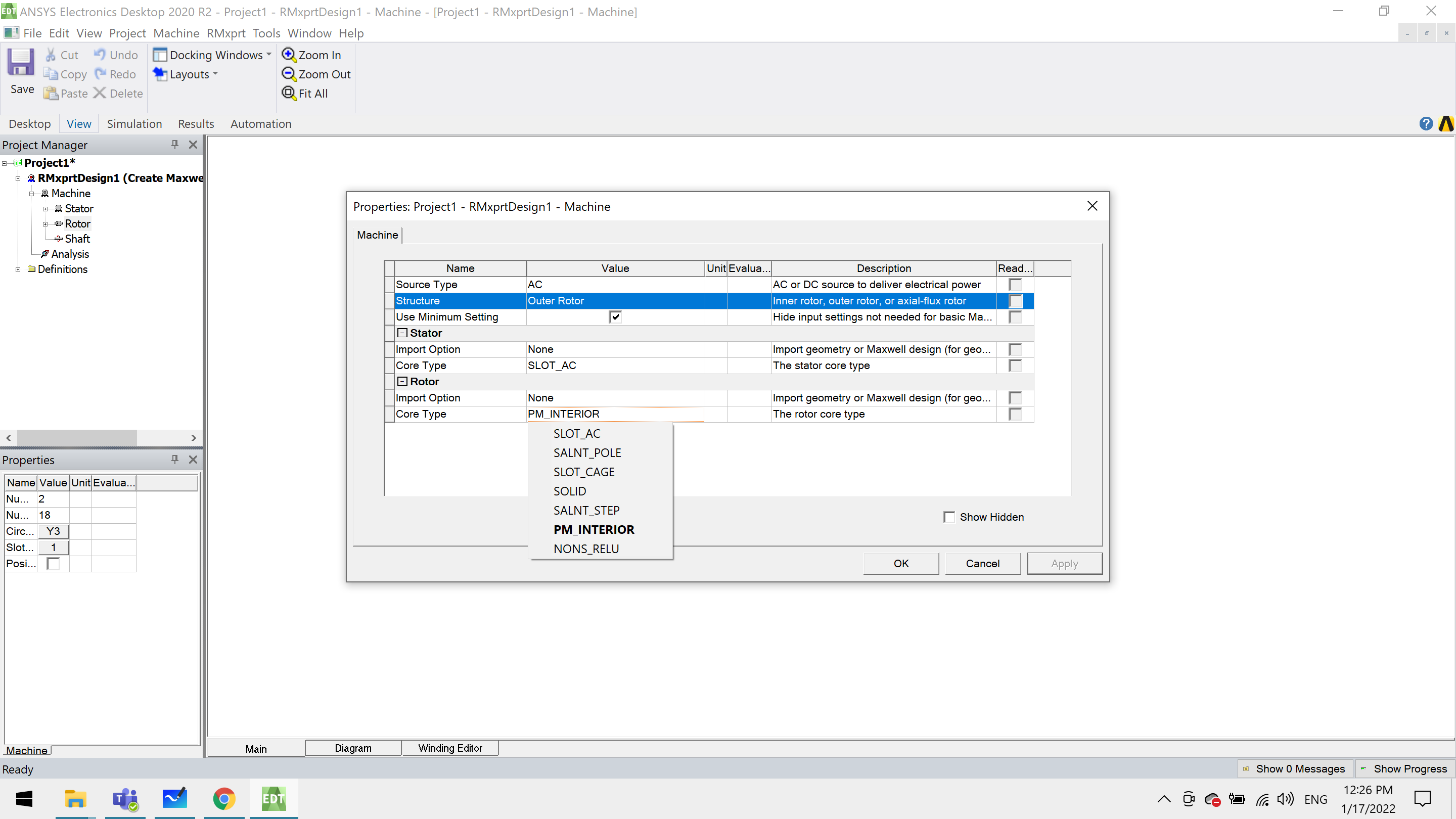

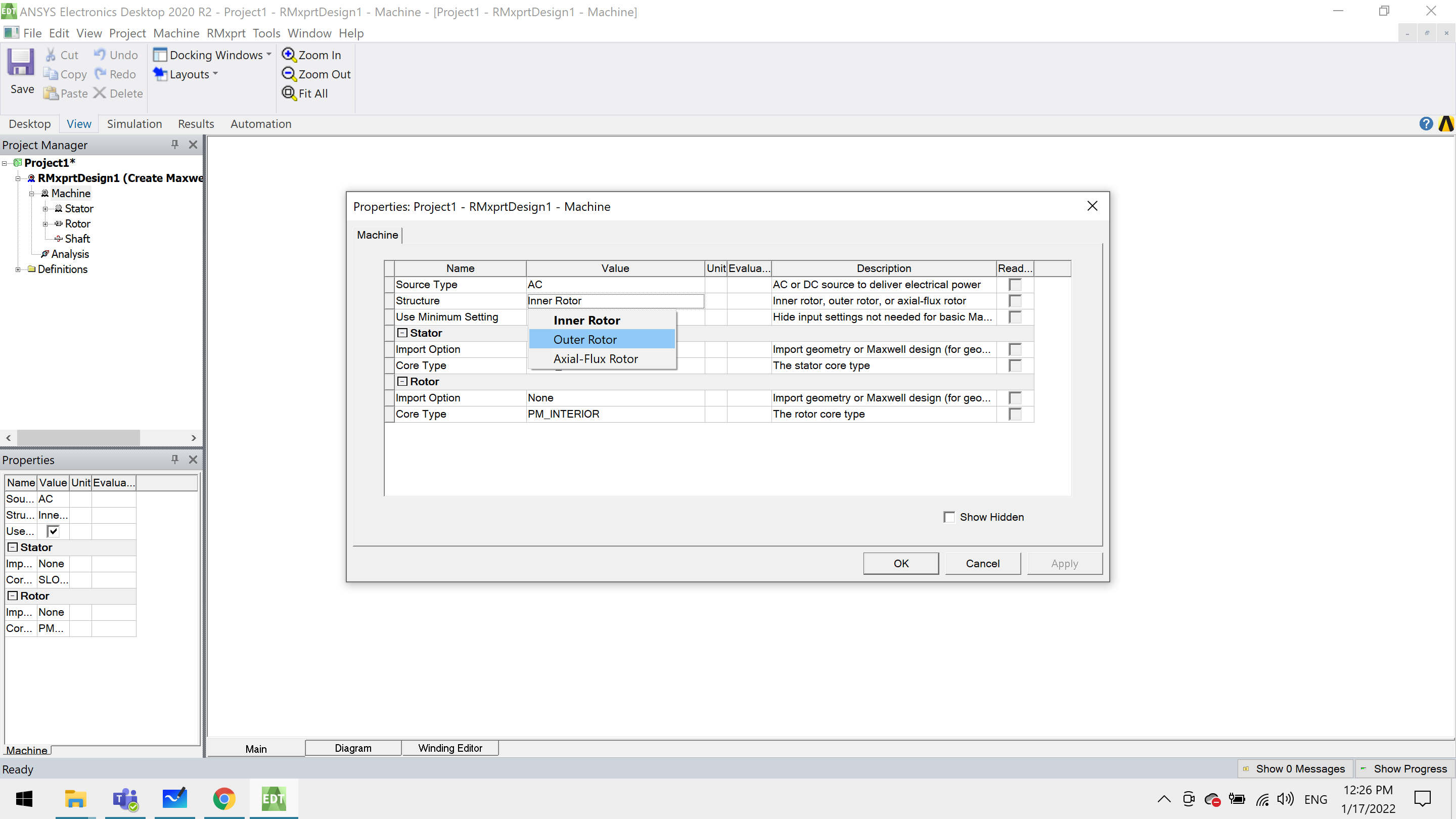

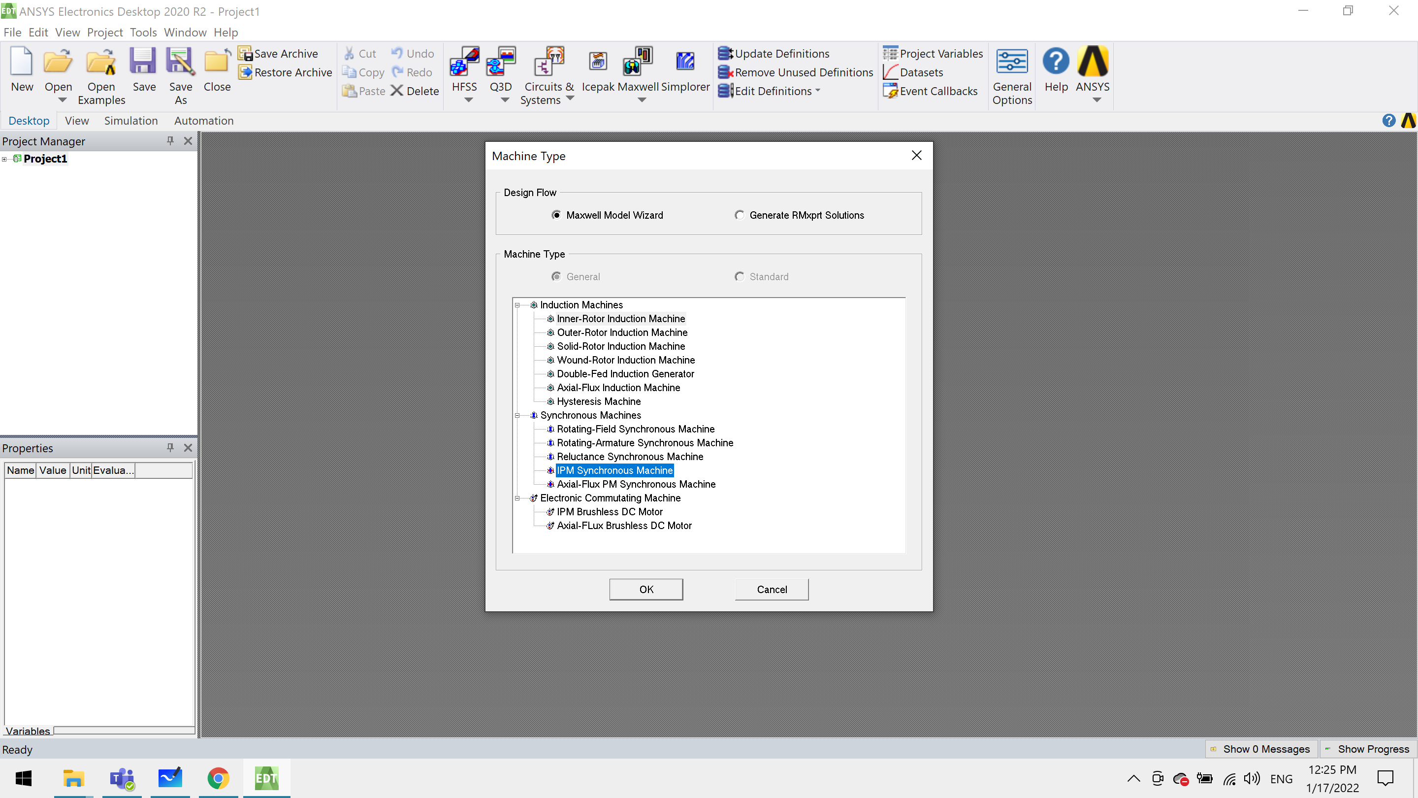

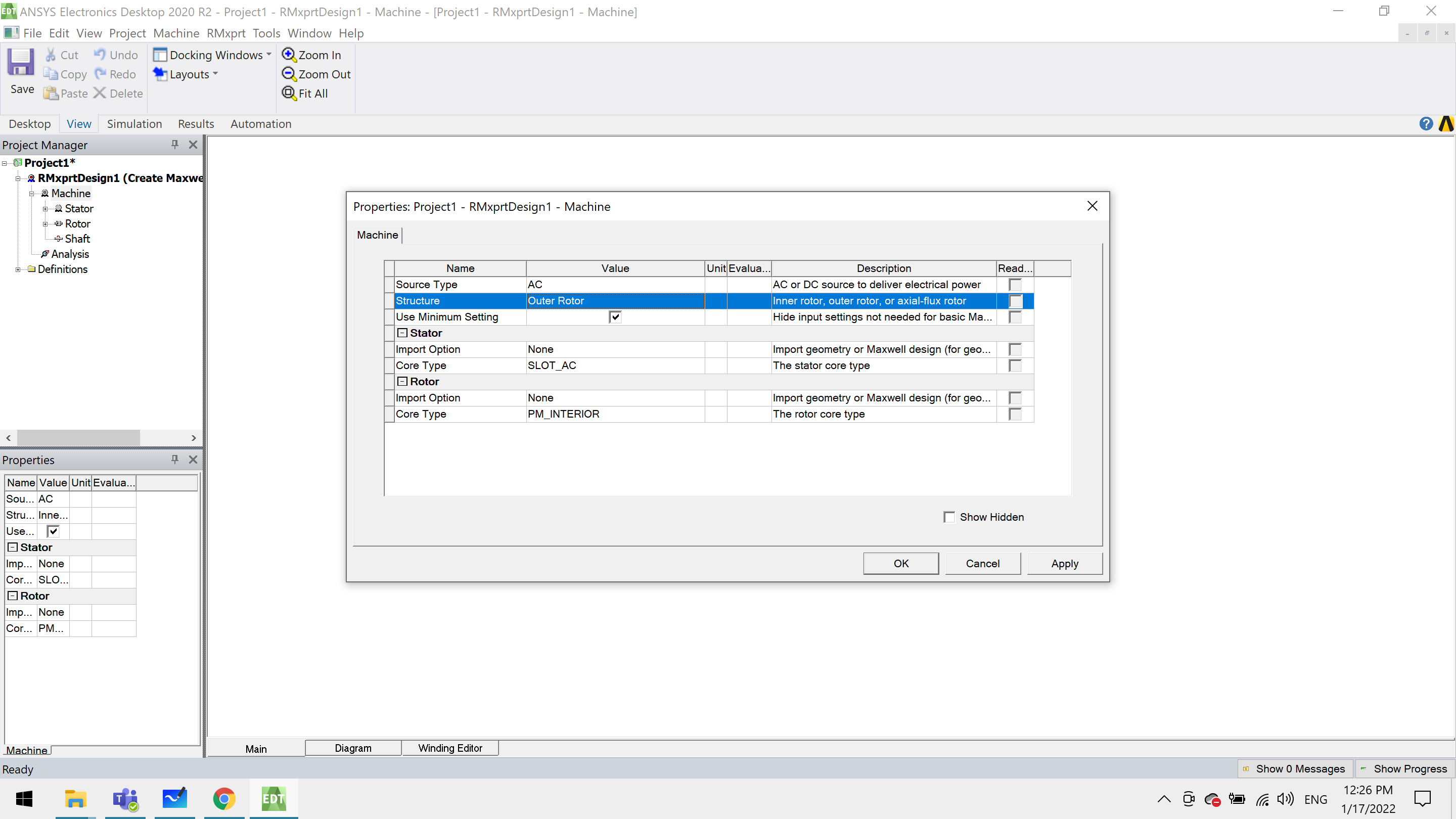

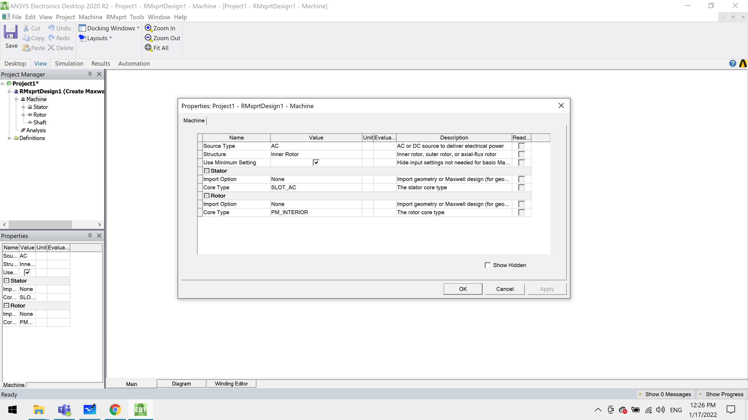

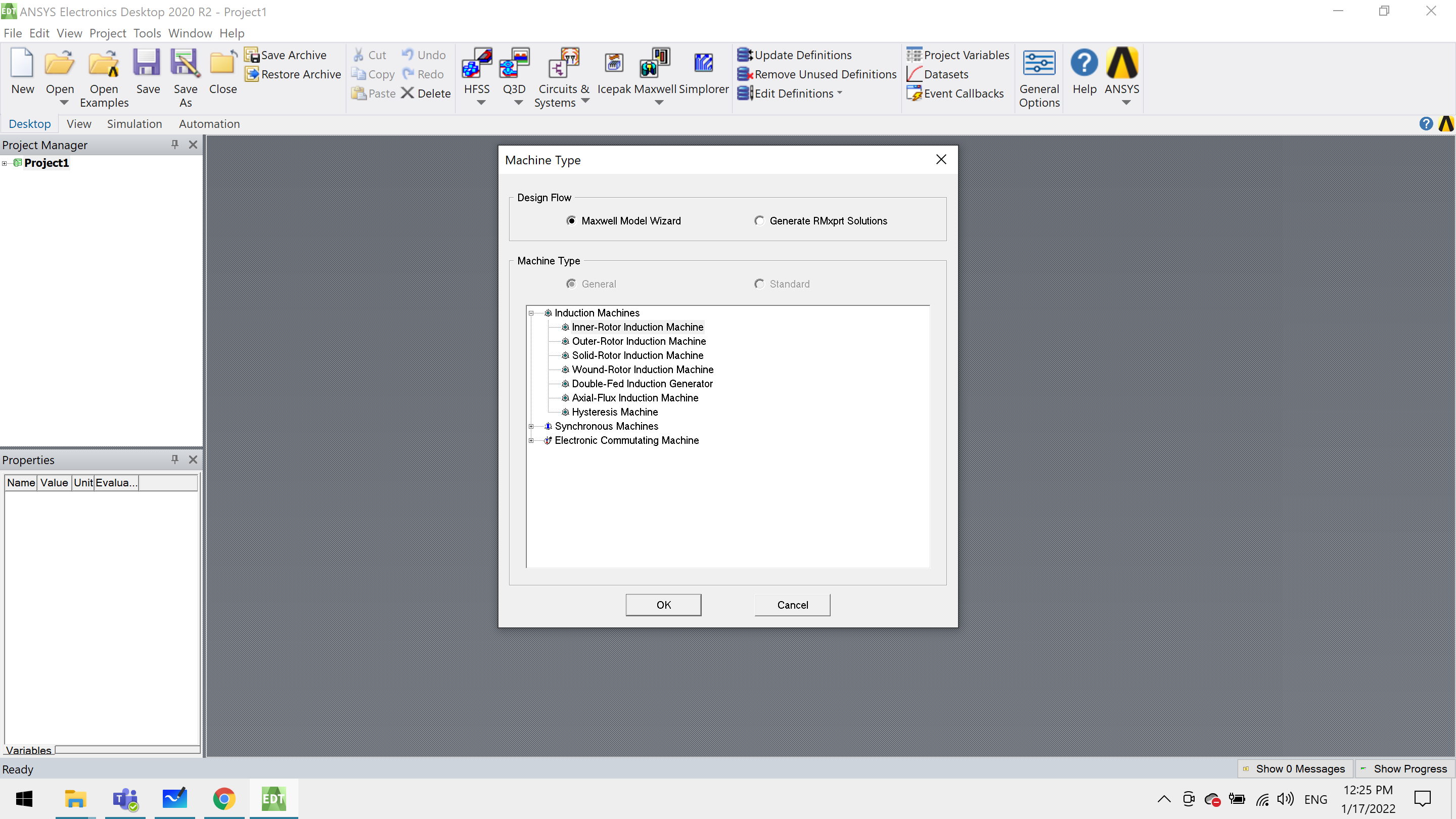

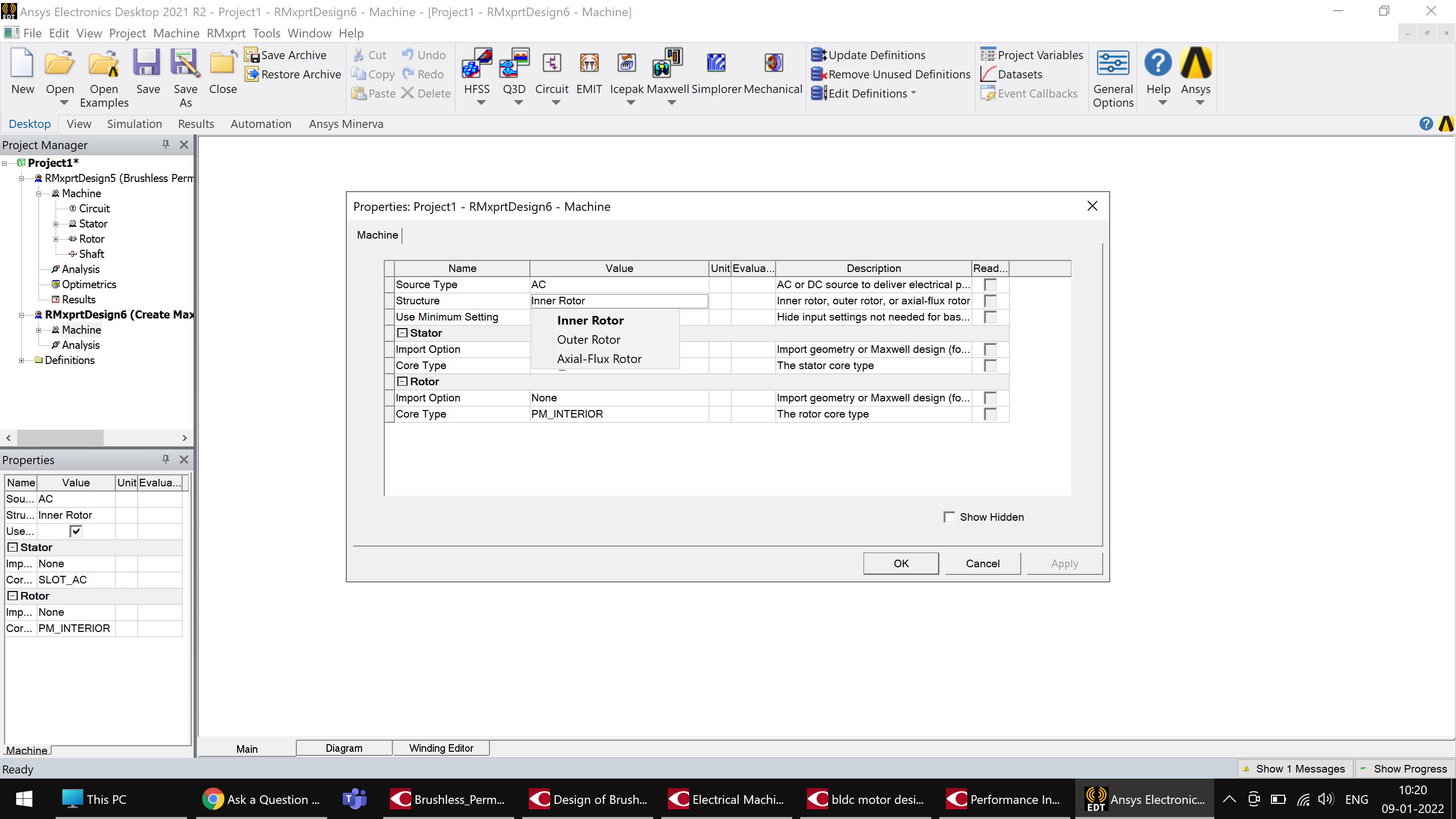

January 17, 2022 at 7:08 ammitul
STEP 2: SELECT MAXWELL MODEL WIZARD OR GENERATE RMXPRT SOLUTIONS
STEP 3 IN MAXWELL MODEL WIZARD SELECT IPM SYNCHRONOUS MACHINE
STEP 4 YOU CAN FIND TYPE OF ROTOR IS "PM INTERIOR" WITH INNER ROTOR CONFIGURATION
STEP 5 SELECT OUTER ROTOR IN STRUCTURE
STEP 6 WITH OUTER ROTOR STRUCTURE PM INTERIOR ROTOR IS THERE.
STEP7 CLOSE THE MACHINE WINDOW AND OPEN IT AGAIN
STEP 8 NOW TYPE OF ROTOR IS CONVERTED TO SLOT AC. I NEED IT WITH IPM CONFIGURATION
THANKS FOR HELP
