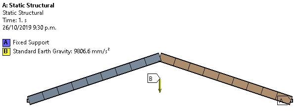

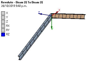

Simple beam model with fixed ends, one revolute joint connecting the beams between end vertices, and gravity load:

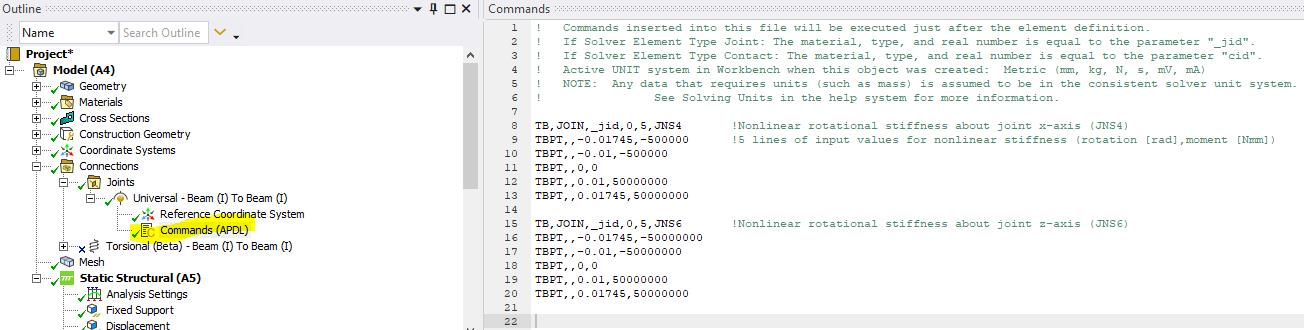

I got the rotational spring to work using your suggestions. I also had success using the TB,JOIN function too. My model consisted on a simple cantilever beam with a Universal Joint near the fixed end. I specified the following command on the joint for bi-linear stiffness in 2 rotational DOF (both negative and positive):

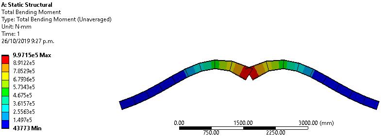

I then displaced the beam at the end in both directions to see the behavior, and as expected, the moment in the beam plateaus at the yield moment as specified:
I found this method more useful for post-processing, as you can obtain joint angles, forces, and moments for validation purposes.
