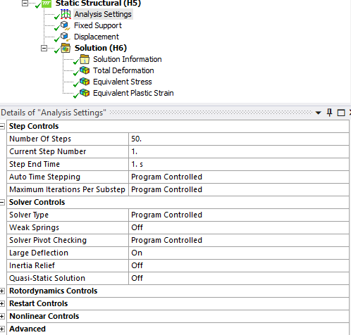

      Hi, I am running a simple cantilever beam deflection with one end of the beam fixed and the other side free. I used a 2nd block to trigger a displacement (like using finger to push the free-end of the beam). Large deflection is "ON". I have tested 2 materials so far, the Ansys built-in Stainless Steel NL and my custom added Copper C19910.

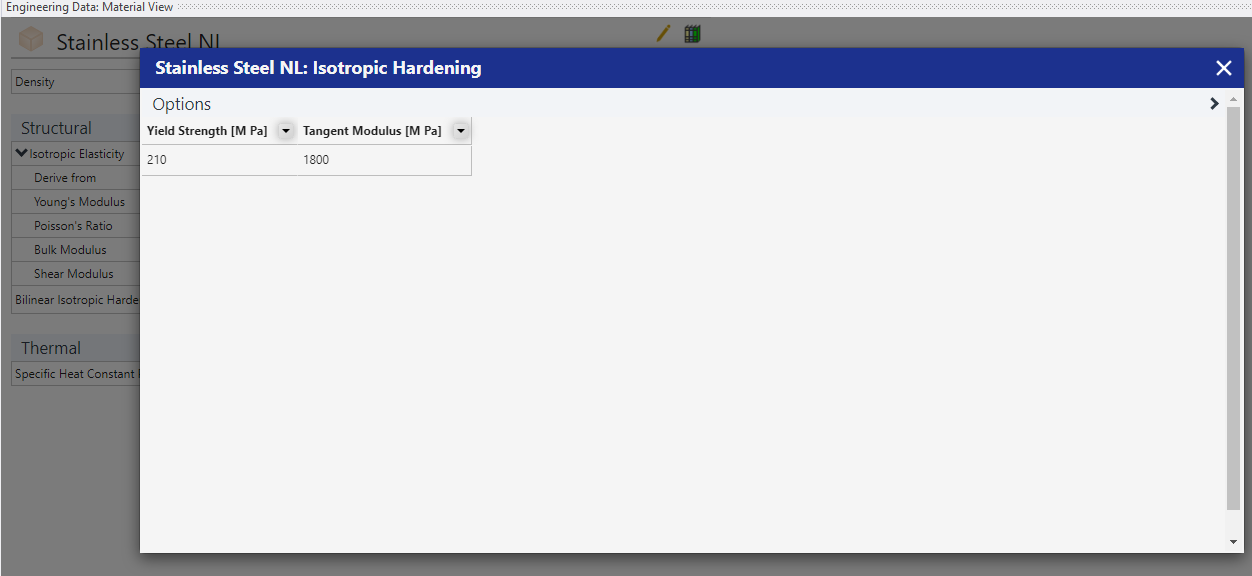

      Both materials in the results yield at a point significantly above the yield strength defined in the NL isotropic hardening data. Depending on the beam geometry, I have seen Stainless NL yield at 260MPa and 380MPa vs the 210MPa yield strength in the material data. The copper is yielding at 1600MPa vs the 1000MPa in the material data.

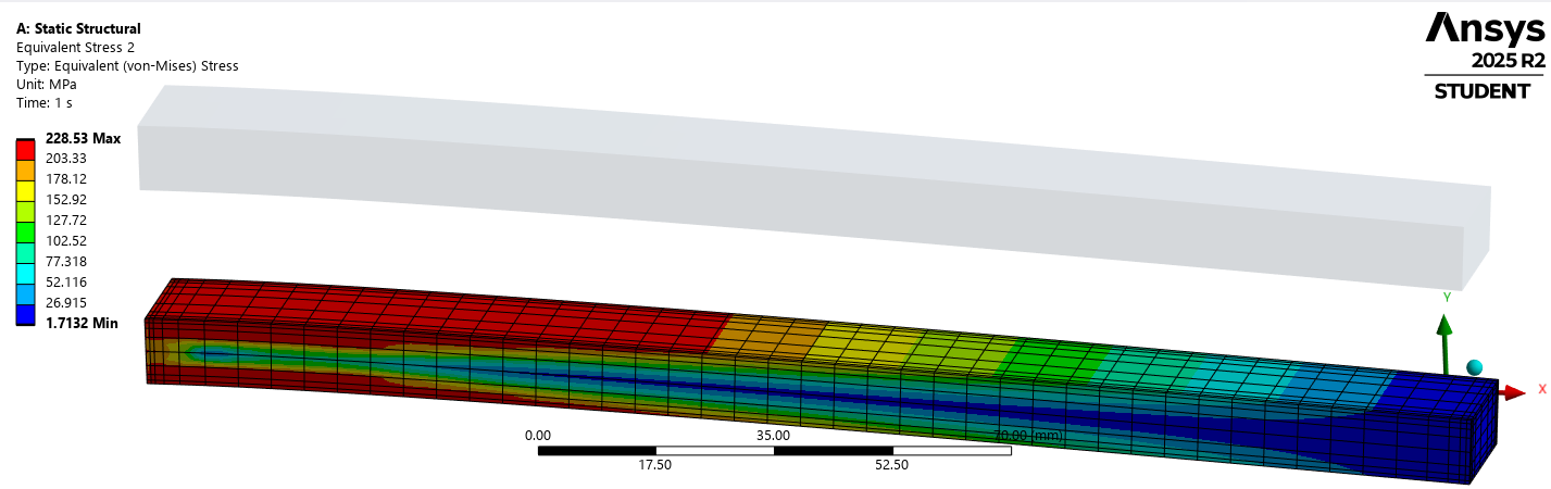

      Hi lewislui,

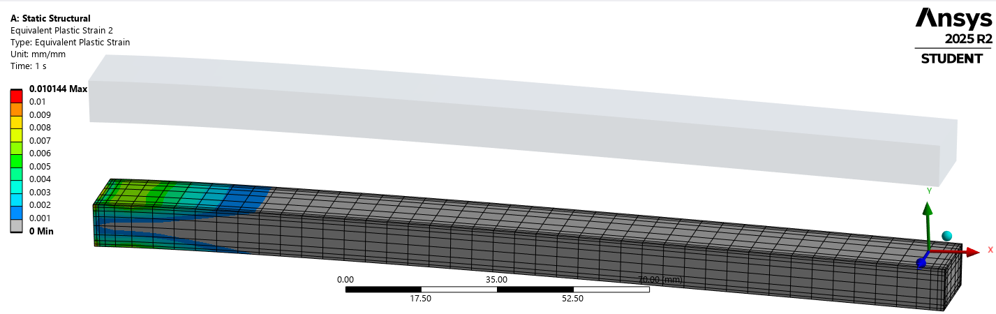

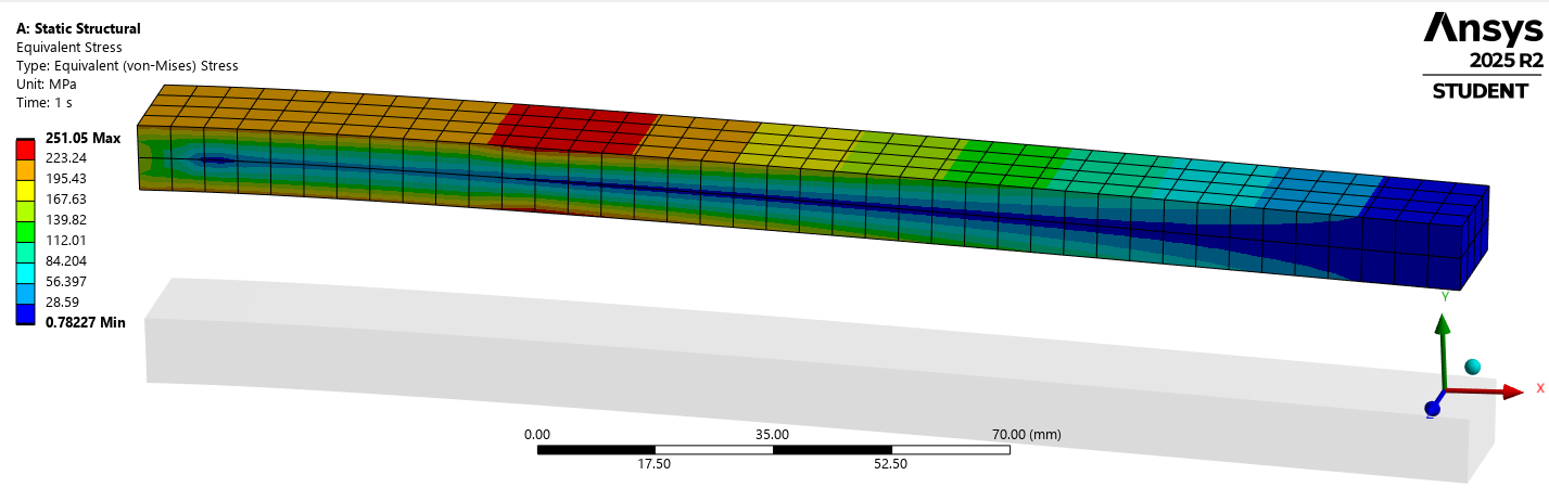

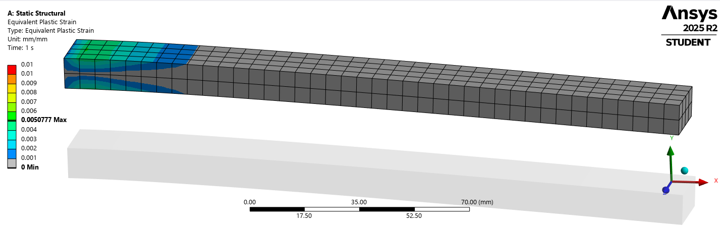

      The reason for the discrepancy is due to the mesh being way too coarse.  In the images below, the identical geometry, materials and boundary conditions are applied to each body. The material is Stainless Steel NL. The only difference is the size of the elements near the outer surface of the body.  The top body has two elements through the thickness while the bottom body has 8 element through the thickness with a Bias Factor of 4 to make the elements near the top and bottom faces much thinner than the elements near the center of the thickness.
      Notice that only half the plastic strain develops in the coase mesh because the elements are too large and the integration points are too far from the surface.  This affects the stress in the bodies as shown below.
