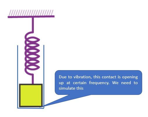

      I'm new to this forum. I need to study the contact status under harmonic response and sometimes in random vibration. I know that, these 2 analysis are linear and nonlinear effect cant be included. Full transient analysis is computationally expensive and not feasible to do. What is the best way to determine contact opening study?

      As you said harmonic and random analysis are linear so can not have/include nonlinearities (like the nonlinear contacts you describe, e.g., frictionless and frictional).
      Transient dynamic analysis is needed here. In this type of analysis, one can have a swept-sine signal (https://www.ni.com/docs/en-US/bundle/labwindows-cvi/page/advancedanalysisconcepts/lvac_frequency_sweep.html)
