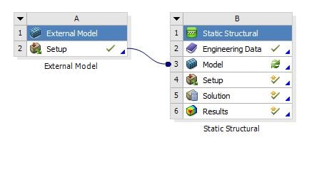

SubscriberI am doing nonlinear buckling analysis using workbench. so that I have done a linear buckling analysis, added imperfection and save it as a .cbd file. Then I used external model tool to import the geometry and shared the data with structural analysis. switched the large deformation and used ARCLEN method to solve the nonlinear analysis. But the problem is the Nonlinear buckling load does not reduces significantly as expected. I have checked all the material properties and all possible parameters. I think the problem with external model. can anyone help me?

Ansys EmployeeAre you running into any specific errors? Have you observed the same behavior for varying mesh size?
Please provide comparisons of your linear and non-linear bifurcation points?
When you mention nonlinear buckling, how are you accounting for the nonlinearity? Geometric (large deflection), Materials or Contact? Be sure to look in the legend to see if Load Multiplier States Linear or Nonlinear? Post snapshots of your comparison.

SubscriberThank you sandeep for your reply.
In my model I am using large deflection alone when I was post here. After that i found that large deflection may create nonlinearity or may not be based on geometry. so in my model there is geometric nonlinearity. Then i added material nonlinearity(MISO), the buckling load is considerably reduced due to this. Now problem is on convergence.Â
Could you tell me above stated words about large deflection is correct or not? also how to improve convergence.

Ansys EmployeeNon-linear buckling is often smaller than the linear buckling.
Improving convergence is a very generic and open-ended question.
Some suggestions have been provided in this post.

Is the geometric nonlinearity(large deflection) has effect on buckling load for all geometries? because in my model simply large deflection alone does not make any impact, after adding material nonlinearity the buckling load got reduced.

Ansys EmployeeWe can't generalize, but of course, large deflection will have an effect, maybe its not significant in the problem you have.Â
