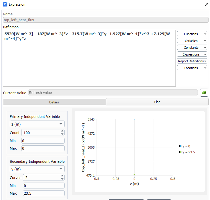

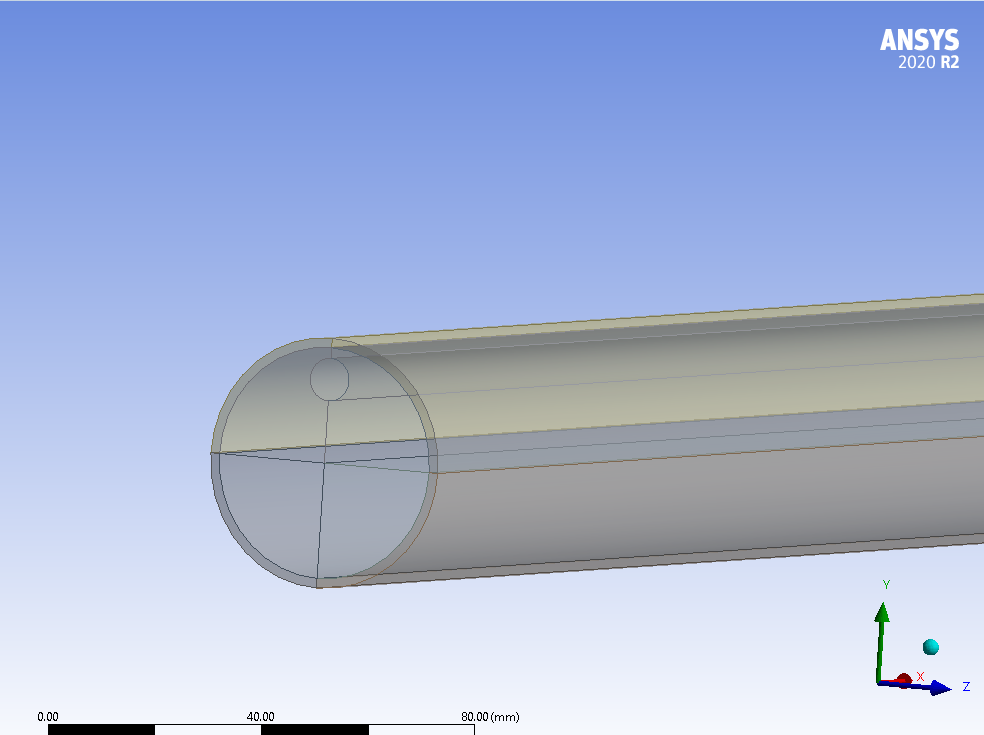

I am currently trying to implement a non-uniform heat flux boundary condition around a cylinder. I have my cylinder split into 4 surface, ie top_left_surface, bottom_left_surface, etc (Figure below)
For each of the outer tube surface, I am trying to implement a heat flux boundary condition via function expression using a polynomial profile that I curve fitted. The profile is for one quarter of the tube surface is implemented as below:

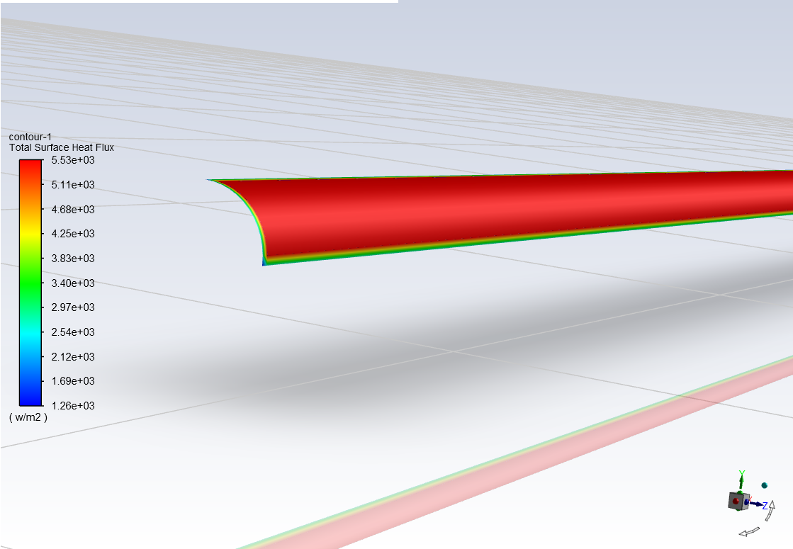

Here, I am assuming "0m" when z = 0, y = 23.5m (where radius of the outer surface is 23.5m). Hence, what i am expecting is that at z = 0 and y = 23.5m, the heatflux there should be about 470.1W/m^2. However, the simulation shows otherwise an the heat flux values are far off from what I am expecting.
I believe there is something I am not understanding with the cartesian coordinates when I am fitting my heat flux boundary curves, or there is something I am not understanding with implementing a polynomial profile on a curved surface. Any feedback on how I can properly implement this is very much appreciated.

Ansys EmployeeYou can use that Expression to plot it on the surface right away to verify if it is what you expect before even running.
You z varies over that surface the same with y. If you are doing a fit perhaps number of figures is important. if the have the data in tabaluted form (CSV) and spatial then you can aslo directly read a CSV file to apply it at the boundary.

You are right! I actually got the problem figured out, it was due to some mismatch in units. Thank you for taking the time to respond!
