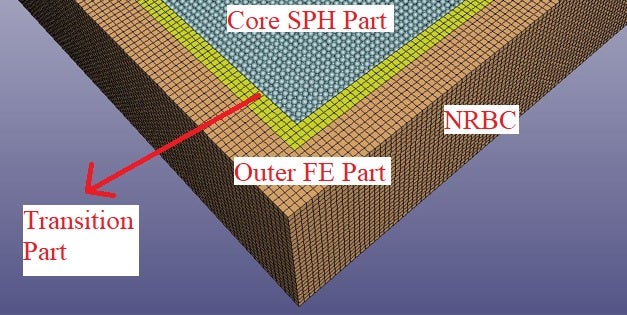

March 1, 2022 at 6:22 pmMohammadMahdi
SubscriberDo you mean like the picture below? So, since the extended solid elements have the same material as the SPH nodes, what do you suggest for the contact between them? If the impact is only between the impactor and SPH nodes, is still DEFINE_ADAPTIVE_SOLID_TO_SPH required in order to eliminate the artificial boundary waves? Thanks in advance for sharing your thoughts with me in this regard.

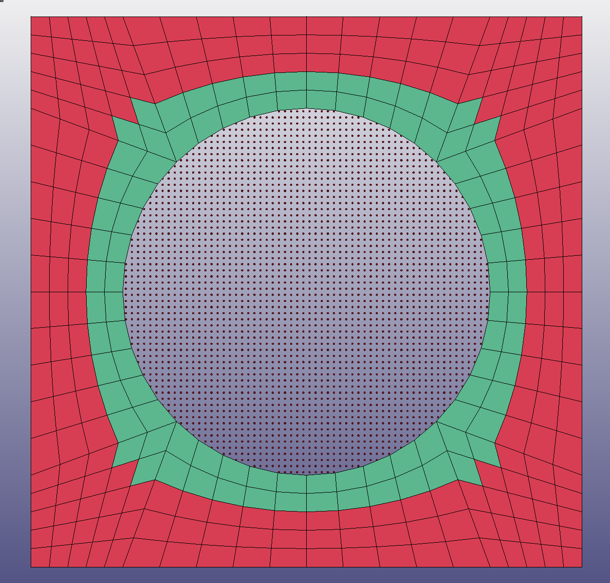

March 2, 2022 at 5:19 pmtslavik
Ansys EmployeePlease see the image below where a square plate is modeled with hexahedral finite elements, SPH particles and a transition layer between them. The outer red part (PID=1) is made of standard Lagrangian finite elements, green (PID=100) treated with DEFINE_ADAPTIVE_SOLID_TO_SPH, and SPH particles comprise the center section (PID=11). The second image below is from the LS-DYNA d3plot results and show the inactive SPH particles embedded in PID=100. Here is the corresponding keyword input data:

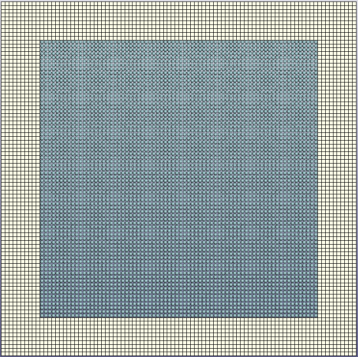

March 11, 2022 at 4:38 amMohammadMahdi
SubscriberI just tried what you said and did not work. In my opinion, since the transition part is a separate part, a contact algorithm has to be defined between the transition part and the core SPH part. The same scenario is required between the transition part and the outer finite elements. I'm gonna try Tied-Node-to-Surface contact card for both, between the core SPH and the transition, and between the transition part and the outer finite elements. I'll let you know if it works.
March 12, 2022 at 7:22 pmMohammadMahdi
SubscriberAs I mentioned before, a contact card is required between the core SPH and the transition part. I used Tied-Node-to-Surface for both, the contact between the core SPH and the transition part and between the transition part and the outer finite elements. The Non-Reflecting-Boundary-Condition was also applied on the outer segments of the outer finite elements. it is working now somehow. I mean, with your suggested method, I'm able to somehow apply NRBC on the target now; however, I'm not sure if the Tied-Node-to Surface is an appropriate select for the contact between the mentioned parts? Please let me know what you think and find the new scenario below:

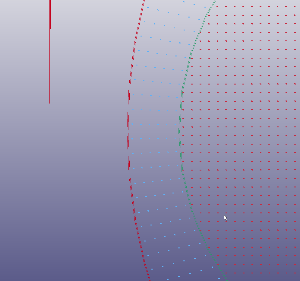

March 17, 2022 at 2:45 amMohammadMahdi
SubscriberI merged/shared the nodes of the outer FE part to the nodes of the transition part and it worked. So, as you mentioned, there is no need for a tied contact between the outer FE part and the transition part treated by *DEFINE_ADAPTIVE_SOLID_TO_SPH. However, the inner SPH and the transition parts do not still recognize each other, though CONT in *CONTROL_SPH is 0 and particle approximation is defined. In your suggested keyword input data above, why the section ID assigned to *DEFINE_ADAPTIVE_SOLID_TO_SPH is 201? Shouldn't it be equal to the section ID of the core SPH part?
March 17, 2022 at 5:56 pmtslavik
Ansys EmployeeYes, that's a good idea. Please try switching IPSPH and ISSPH to match the ID's of your SPH part. It would be helpful to make a simple model to test this arrangement - one finite element, one transition element and a handful of SPH particles. You could paste the contents that entire model in this chat if you have trouble.
