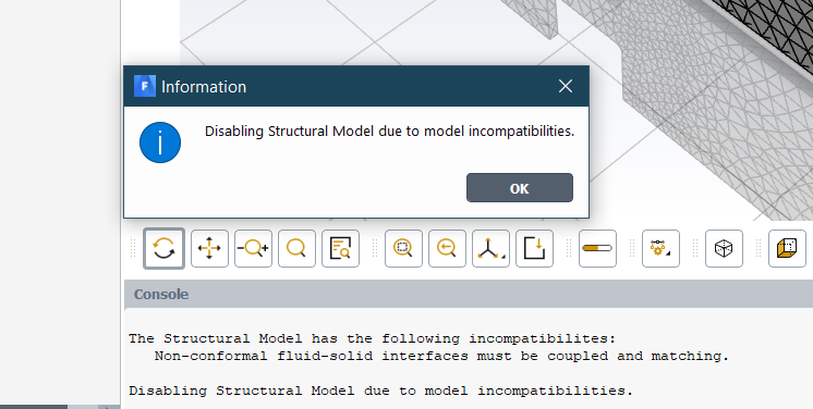

      I am doing a 2-way 3D FSI simulation and getting an error whenever I enable the "Structure" option in FLUENT.. (screenshot attached)
      i am using Ansys 2020R1 student version.
      I know it has something do with what i am doing in design modeler or meshing phase but I cant really figure it out..
      In meshing, I am using contact detection along with 'contact sizing' and meshing method is 'tetrahedrons' with 'patch conforming' enabled.
      The mesh interface in fluent has "coupled" and "matching" options enabled..
      I was able to get it enabled previously but my harddisk crashed and had to reinstall Ansys 2020R1.. Have been facing this issue since then.
      The text in the TUI is the clue here. You've got a non-conformal boundary between the fluid and solid zones. In DesignModeler you need to make a multibody part to avoid this. Note, it will increase your cell count.

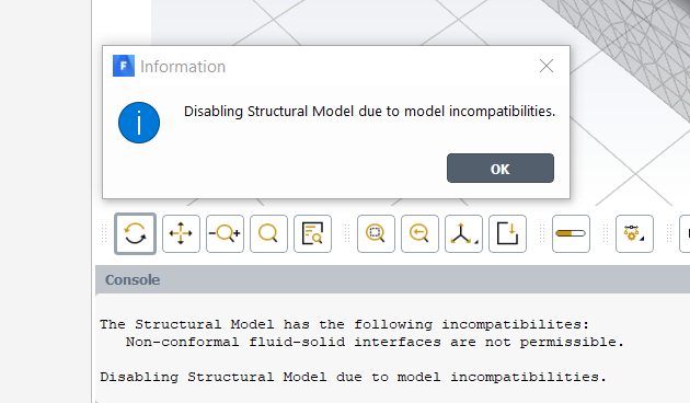

      So this the error i used to get when using non-conformal interface in fluent, previously. (notice the 2nd line in TUI)
      I would just edit the interface as "coupled and matching" under 'mesh interface' option and could easily continue with FSI even with nonconformal interface..
      Now i am getting a plain error that its not permissible. Have they disabled it or something?
    • ahmadkhan
      Hey, Thanks for the help.
      I was able get structure enabled with non-conformal mesh (matching and coupling enabled) after doing a clean install of Ansys 2020R2..
