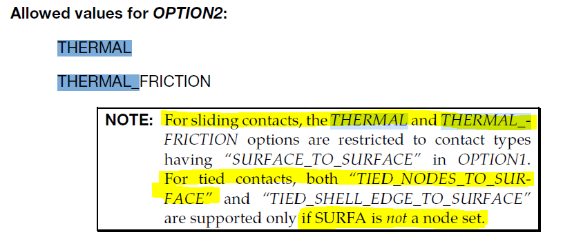

      Is nodes to surface thermal contact supported in LS-DYNA. I received a warning:
      *** Warning 20660 (STR+660)
           in definition of contact 1
           Contact must be surface_to_surface
           for a thermal problem. This contact
           surface will be skipped during the
           thermal calculations.
      when I started the simulation. In this simulation, I was modeling the contact between tool and workpiece, where the tool is modeled using FEM, and the workpiece is modeled using SPH.
      Thanks!
    • Reno Genest

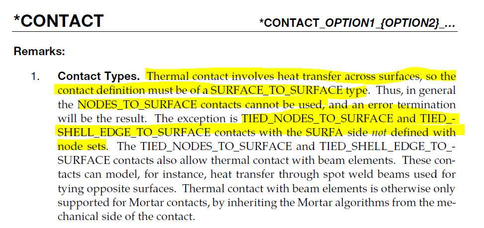

      Hello hansenli,
      There is the following  information in the LS-DYNA user manual vol I:
      If you are able to use one of the supported nodes to surface contact without specifying a node sets, then maybe it could work. Otherwise, I am not sure how you can define a thermal contact between FEM and SPH.
      Could you use FEM instead of SPH in this case?
      Reno.
